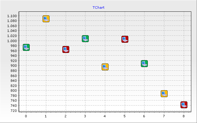

If I understand you correctly, you would like to have a unique image, with just the computer without any back color, to always load the same image in the hole series and then, you would like to draw a green/yellow/red background to the image. If this is what you meant, it could probably be possible but you would probably have to draw manually the background color at OnBeforeDrawSeries event for example.
However, I think it would be easier to have three images, one for each background color. Here you have an example:
uses TeePNGImage;
  Chart1.View3D:=false;
  Chart1.Legend.Visible:=false;
  with Chart1.AddSeries(TImagePointSeries) as TImagePointSeries do
    FillSampleValues(9);
    Pointer.HorizSize:=23;
    Pointer.vertSize:=23;
    OnGetImage:=Series1GetImage;
procedure TForm1.Series1GetImage(Sender: TCustomImagePointSeries;
  ValueIndex: Integer; Picture: TPicture);
  if ValueIndex > -1 then
  case (Round(Sender.XValue[ValueIndex]) mod 3) of
    0: Picture.LoadFromFile('C:\tmp\green.png');
    1: Picture.LoadFromFile('C:\tmp\yellow.png');
    2: Picture.LoadFromFile('C:\tmp\red.png');
