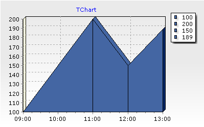

Thanks, I think I've got a clue...now I wonder how to use your first suggested approach without inserting visible Y values?
I mean if there is actually no data on 10 o'clock, how to make sure that the "10:00" tick and label will still be there on X-axis? Thanks again.

Post by Yeray » Thu May 10, 2012 3:00 pm
sswang wrote:Thanks, I think I've got a clue...now I wonder how to use your first suggested approach without inserting visible Y values?
I'm not sure to understand you. If I comment the following line in Sandra's code above
//    Series1.AddXY(EncodeTime(10,00,00,00),99);
This is what I get, still with the axis label "10:00"
