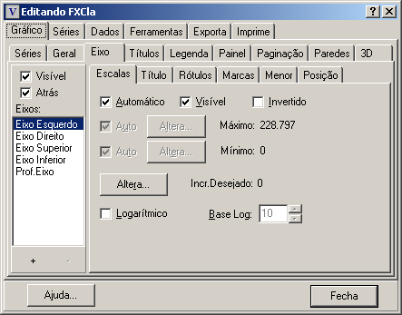

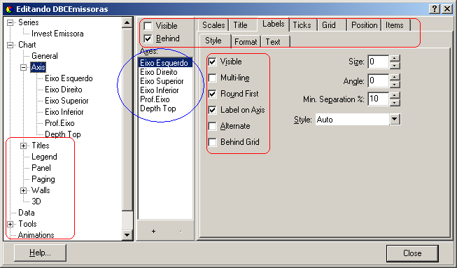

thank you for your reply. I came from Teechat Pro 5. In version 5, when we click button "edit" all labels from all tabs and buttons are translated (see attach Teechart 5 Pro). In version 2012 some labels are translated (circled in blue) but many labels are untranslated as we can see in the attached file Teechart 2012 (circled in red). It seems that there are many labels left behind, i.e., not translated.
Unfortunately, the hints of buttons of TTeecommander of both versions are untranslated.
Best regards,
Sergei Safar
Best regards,
Sergei Safar

Re: Can't get teechart translated
Hi Sergei,
You are right. I've seen it was broken between v2011.03 and v2011.04. I've added it to the defect list to be revised (TV52016197).
Thanks for reporting it.
