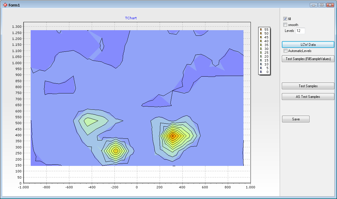

I have here an issue with the contour series. some time ago we have had trouble getting out Load Cell wall (LCW) plots correctly with this type of chart because of white triangles (see ).
But at least since TChart 2012 the problem has gone. My new ploblem now is, that the filling area will not match the contour series border lines with our real world data sets.

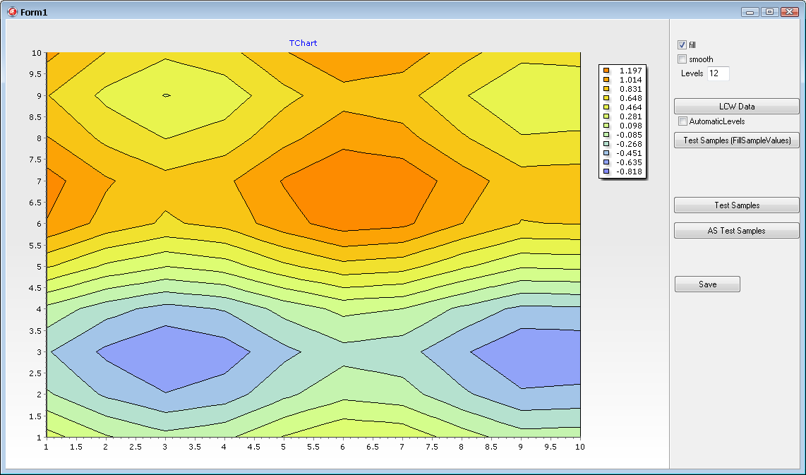

If I use generated data for the fill everything will look nice:

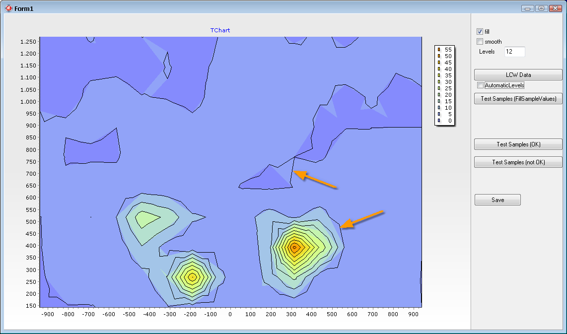

If I use our data I have differences:

I see in the code in Button_LCWDataClick:
  If Sender = Button_LCWData then
    Chart1.LeftAxis.Automatic := False;
    Chart1.BottomAxis.Automatic := False;
    Chart1.LeftAxis.Minimum := 0;
    Chart1.LeftAxis.Maximum := 1337.5;
    Chart1.BottomAxis.Minimum := -1000;
    Chart1.BottomAxis.Maximum := +1000;
However, when pressing that button, the data being loaded goes from Z 142 to 1268 and X from -938 to 938. That's why setting the minimum and maximums above results in the margins in your pictures.
Changing it for the following to let TeeChart calculate the axes min and max for you, seems to work fine for me here.
    {Chart1.LeftAxis.Minimum := 0;
    Chart1.LeftAxis.Maximum := 1337.5;}
    Chart1.LeftAxis.Automatic:=true;
    {Chart1.BottomAxis.Minimum := -1000;
    Chart1.BottomAxis.Maximum := +1000;}
    Chart1.BottomAxis.Automatic:=true;
Don't hesitate to let us know if there's anything else you want us to check.

I guess I have not explained clearly the problem we have in this example. It is not that the plot did not fill the complete graph area. You are right that we could establish this by setting the axis to automatic.
The fixed axis limits are intended to visualize the LCW geometric always in the same scaling.
The issue is that in the FillSampleValues-Example the colored areas are always surrounded by black lines that are matching the contour of the color region.
But in our LCW-plots the colored areas (levels) do not match the border lines. It seems the border lines are drawn for different values?
The two buttons below are just to show you that there are also more simple configurations available that leads to this mismatch.
I have added some arrows to point at some mismatch areas.
So any recommendation is welcome to overcome this issue.
Thanks for you help and bye,
Dirk
Re: Contour Series Fill not matching contour lines
Post by Yeray » Tue Aug 07, 2012 8:13 am
Hi Dirk,
Sorry, I misunderstood you.
I'm afraid this is a known complex issue. And I'm afraid we haven't a solution to it besides completely redesigning Contour and IsoSurface series.
You'll find how it has been discussed in several threads:
http://www.teechart.net/support/viewtop ... ace#p45359
