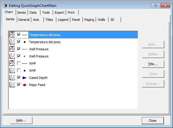

To better control symbol placement for dense data sets, I create a LineSeries, a FastLineSeries and a PointSeries for each set of data. The LineSeries is used only for the legend, while the other two series show the line and the points respectively. I have a lot of custom code to format the resulting graph, but also make ChartEditor available so advanced users can "tweak" the graph to their own preference.
When I open ChartEditor, all 3 series are displayed. I have attempted to hide the FastLine and Point series with the following code:

This code has no effect on ChartEditor as seen in attachment. Any ideas what ShowInEditor fails would be appreciated.

Further to my previous submission, I see that the HideInEditor code does not hide the FastLine and Point series but does hide the LineSeries. Without the code, all 3 series are shown in the editor.

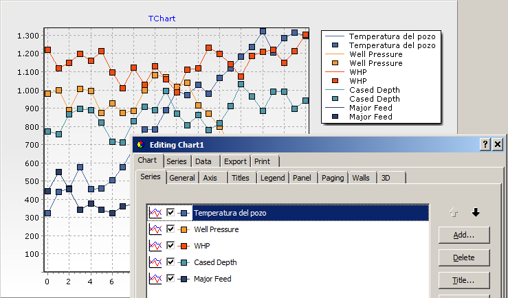

I've made a simple example trying to reproduce your situation (all in a single unit) and it seems it works fine for me here, if I understood correctly what you are trying to achieve.
The series with data, TLineSeries, are drawn in the chart and shown in the editor but hidden in the legend
The series without data, TFastLineSeries and TPointSeries copied (just the title and the color) from the TLineSeries, are hidden in the editor but shown in the legend.
Isn't it what you are trying to do?

Re: Hiding series in Chart Editor
Hi Yeray
Thanks for your reply. Note that all 3 series have the same data and settings (line color, symbol, line type, etc) as appropriate. The LineSeries is used only to show the legend - its DataSource is set to nil just before the chart is drawn so no data is plotted. The legends of the FastLineSeries and the PointSeries are hidden but the data is plottted. Doing it this way means that I can control the point frequency (for example draw every 10th symbol in the series) while a FastLineSeries is plotted correctly for non-solid lines and dense data, at least for line width = 0 or 1.
