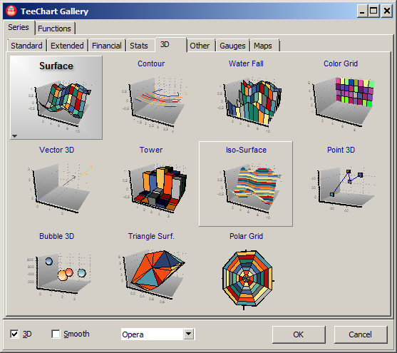

I have Teechart pro installed, & I can see it in Component>install packages
I want to use the TPolarGrid component, but when I go into Tchart gallery>3D I get a 'no-entry' symbol as my mouse pointer, when I hover over all the 3D series types.
any advice on what schoolboy error I am committing would be very appreciated.
cheers, Brian

Sunshine wrote:I want to use the TPolarGrid component, but when I go into Tchart gallery>3D I get a 'no-entry' symbol as my mouse pointer, when I hover over all the 3D series types.
I can't see any error or problem when I move the mouse over the 3D tab in the series gallery at design time nor at runtime.
Using TeeChart v8.08 in Delphi 2010.
Could you please show us an screen shot of the problem?
