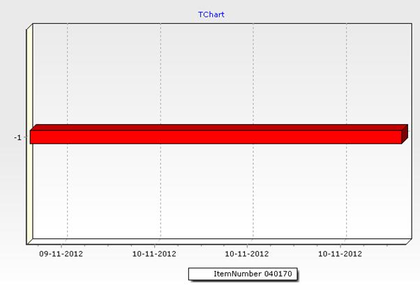

When using the code below, the legend does not indicate the red color - Is this a bug or am I doing something wrong...??
Chart1.Legend.Visible := true;
Chart1.Legend.Alignment := laBottom;
Chart1.Legend.LegendStyle := lsSeries;
with Chart1.AddSeries(TGanttSeries.Create(self)) as TGanttSeries do
    ParentChart := Chart1;
    Title := 'ItemNumber 040170';
    ShowInLegend := true;
    //ColorEachPoint := false;
    with Chart1[Chart1.SeriesCount-1] as TGanttSeries do
        Pointer.VertSize:=10;
        AddGanttcolor(now,now+1,-1,'',clred);

Hi Hans,
It's a normal behaviour.
When ColorEachPoint is true, as you'll understand, TeeChart can't decide what point color to use as the whole series color.
Also note, the TGanttSeries has the ColorEachPoint property as true by default.
However, setting it to false and assigning a color to the series, I think works as you'd like to.
uses GanttCh;
  with Chart1.AddSeries(TGanttSeries) as TGanttSeries do
    ColorEachPoint:=false;
    Color:=clRed;
    AddGanttColor(now,now+1,-1,'',clred);
