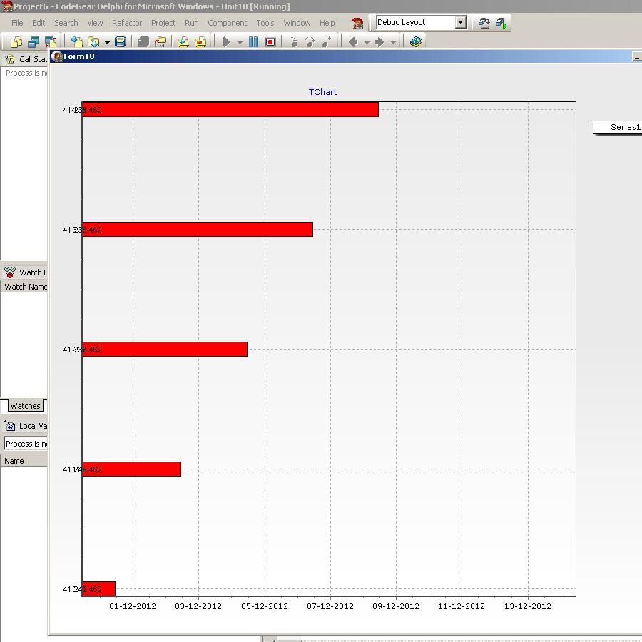

When making the code below, The marks seems to interfere with the LeftAxis Labels. I have attached a figure illustraing the problem. How can I avoid that??

The problem seems to be related to the problem with
Marks.Transparent := true;

Actually, what I would like is that, that part of the marks that are "outside" of the Chart area is not being shown. So that the area with the Left Axis Labels does not show the marks at all.

This is a clipping, isn't it? There's a property for it: Marks.Clip

I didn't know that property existed - Thank you; it works fantatsic know :D
