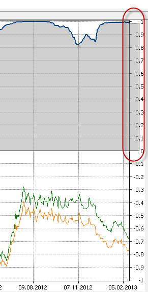

I have attached the region tool to a line series. If I move/scroll the series, the region tool draws outside the chart area (within the y-axis area). The lines itself are truncated correctly but the region is drawn outside. This happens on the left and on the right side of the chart. I have the 121105 VCL 32bit build installed.
Any hints?
See the SeriesRegion tool drawing outside of charting area.
08-03-2013 07-00-14.jpg (51.76 KiB) Viewed 7115 times

I've added it to the wish list to be included in future releases (TV52016532).

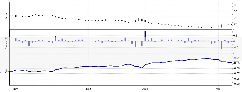

I would like to add that this happens also on the vertical axis. See the attached screenshot. Note the scale of the series on the bottom ("Beta") goes from approx. -0.04 to -0.09. The regiontool draws to the 0 value but this is outside of the boundary given for that series axis. It is already in the area which belongs to the middle series ("Change (R)").
14-03-2013 18-52-22.jpg (72.05 KiB) Viewed 7035 times

I've updated the TV52016532 ticket. Now it says:
Clip the TSeriesRegionTool to the rectangle defined by the axes associated to the tool.
I think it covers both cases. Don't hesitate to let us know if you feel it doesn't.

This is just to let you know we've just fixed TV52016532, so it will be included in the next maintenance release.
