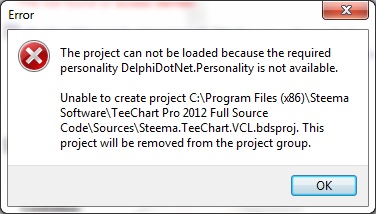

I am trying to load the TeeChart Pro 2012 Full Source Code ...Steema.TeeChart.VCL.bdsgroup into my Delphi 2009 IDE. I get the error in the attached jpeg file related to missing personality file.
After dismissing the error dialogs, nothing is loaded into Delphi IDE.
What can I do?

- Capture of error dialog
- ProjectError.jpg (34.54 KiB) Viewed 6859 times

Hi Kent,
The recommended way to build the sources is using TeeRecompile utility shipped with the TeeChart sources.
If you still want to build the packages manually, you should load the desired .dpk. Note you can have several dpks loaded at a time, creating a .groupproj.
You can also find some .groupproj in the sources.

I was just following the instructions in Install.txt. There is no mention there about TRecompile utility. I will try the utility.

I rebuilt using TReCompile.exe.
Which dpk should I pull into my project in order to debug into the TeeChart source code? My project presently references Tee912.dcp, TeePro912.dcp and TeeUI912.dcp.
There are so many dpk's, I don't know which ones I should use.

Hi Kent,
If you want to directly use TeeChart sources in your projects, you can put the Sources folder in the Library list, and remove the references to the TeeChart's Lib, Include or Lib\Obj folders.
