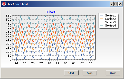

Our sample code is following.
This sample is drawing 4 series.
The AddXY function calls per 2ms.
The buttom axis is changed by OnAfterAdd event.
This problem rarely happens.
I think these would not be special.
Please tell me what do I do.

I've created a new simple example project to test it. Your multimedia timer gives me some errors so I've used a regular TTimer:
I've only added a TTimer and a TChart with 4 TFastLineSeries at design time, and the following code works fine for me here:
Code added at the .h:
Code added at the .cpp:
public: // User declarations
int m_uint32Count;
double m_arl64Value[MAX_SERIES_COUNT];
void __fastcall TForm1::Timer1Timer(TObject *Sender)
double rl64Value;
double rl64Time = (Now().Val) * 86400.0;
this->m_uint32Count++;
if( this->m_uint32Count == 500 )
this->m_uint32Count = 0;
for( int i = 0; i < MAX_SERIES_COUNT; i++ )
if( this->m_uint32Count < 250 )
this->m_arl64Value[i] += 1.0;
this->m_arl64Value[i] -= 1.0;
this->Chart1->Series[i]->AddXY(rl64Time, this->m_arl64Value[i], "", this->Chart1->Series[i]->SeriesColor);
void __fastcall TForm1::FormCreate(TObject *Sender)
m_uint32Count=0;
Re: Access violation in tee9170.bpl
