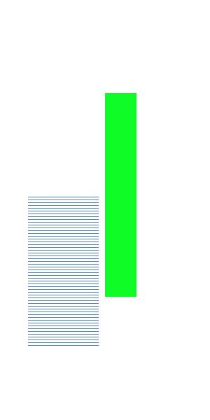

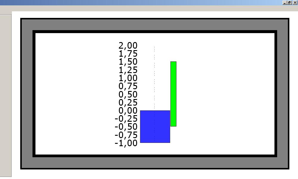

I have a linear gauge (see attachment Gauge.jpg). I would like to change the brush of the hand like this
Hand.Brush.Style := BsHorizontal;
so that the hand will have horizontal lines similar to the attached sketch "sketch.jpg"
However, setting brushstyle to BsHorizontal does to seem to work - what am I doing wrong?

Hi Hans,
Right, the pattern colors are difficult to control. A revision of the Patterns is already present in the wish list as an enhancement for future releases (TV52016522).
I've found what could be a fix for the issue you've reported. It would allow you to draw the blue&transparent pattern in the LinearGauge Hand. However, possible collateral damages are being studied.
