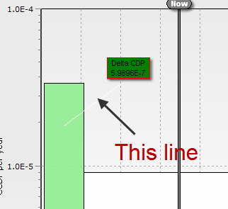

I don't know what they are called, see attached image.
I tried the
seriesPt.Marks.Callout.Pen.Color:=clRed;
but it did not work.
Here is code I use to get the attached image.
seriesPt.Marks.Callout.Pen.Color:=clRed; //I also put this at the end of the code below
ptIdx := seriesPt.AddXY(xval, yval);
seriesPt.Marks[ptIdx].Visible := showIt;
seriesPt.Marks[ptIdx].Color := clGreen;
seriesPt.Marks[ptIdx].Pen.Color := clRed;
line color.png (7.25 KiB) Viewed 8323 times

Try this:
seriesPt.Marks.Callout.Arrow.Color:=clRed;

Post by INL2 » Thu Apr 25, 2013 6:25 pm
Thanks, that worked good.
