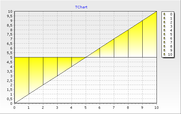

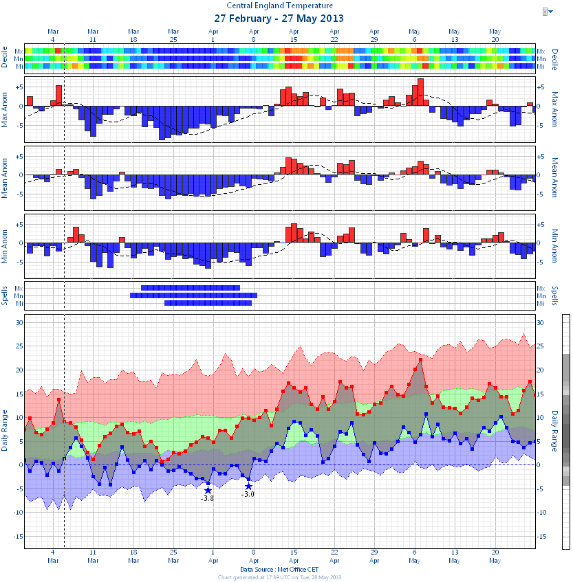

When I use an area a series and set an origin the colors are set out perfect (see 1st screen shot).

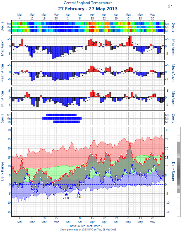

When I make the gradient visible the area above the origin is filled but the area below the origin is not filled with the gradient colors (see second screen shot).
Is there anyway round this problem or is this just how it is?
Bruce.

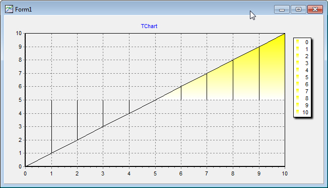

Narcis
Setting the origin works fine but...
Using the exact code you gave me illustrates the problem I reported about there being no gradient color fill below the origin...
I am using Delphi 2007 with TChart 8.08
Bruce.

Re: Area Series and Color Fill

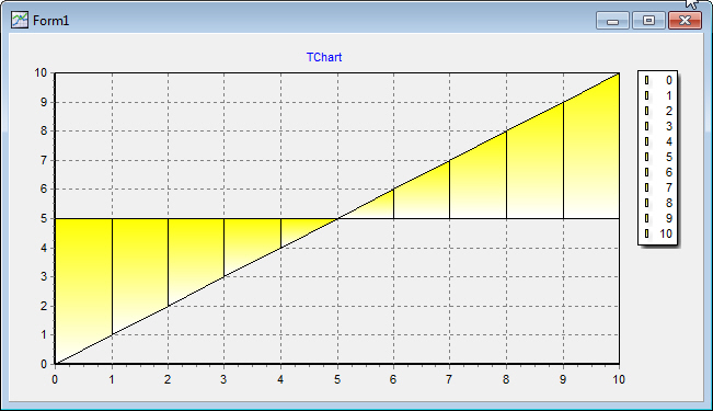

Sorry I should have sent this screen shot...

I've now created a brand new form added a TChart component and then added the code in the OnCreate and the results are the same!

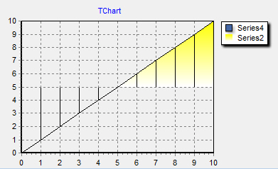

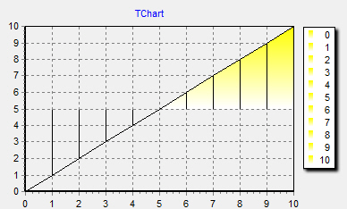

As for the original problem see screenshot!
