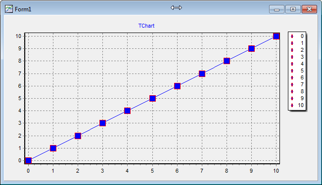

I've tried this from scratch:
var
  Series1 : TLineSeries;
    i       : Integer;
  Series1:=TLineSeries.Create(Self);
  for i:=0 to 10 do
    Series1.Add(i);
  Series1.Color:=clBlue;
  Series1.Pointer.VertSize:=6;
  Series1.Pointer.HorizSize:=6;
  Series1.Pointer.Visible:=True;
  Series1.Pointer.Brush.Color:=clWhite;
  Series1.Pointer.Brush.Style:=bsSolid;
  Series1.Pointer.Pen.Color:=clRed;
  Chart1.View3D:=False;
  Chart1.AddSeries(Series1);
I think I have the code correct to fill in the middle of the point solid white.
The result is the same.
I've checked my library paths correct
I've checked that the new trial version component is correctly installed.
Never had any problems with 8.0.8 until I switched to your 2012 version on Tuesday. :(
Any ideas?
Bruce.
