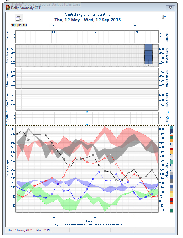

I have added added the canvas and set to default as suggested but as you can see from screenshot 1 the titles come out OK but the axis titles and labels are all system fonts when they should all be Segoe UI. The problem is still there if you switch to Arial. As far as I can see if the font is bigger than 9 it's fine but if smaller it defaults to the system font.

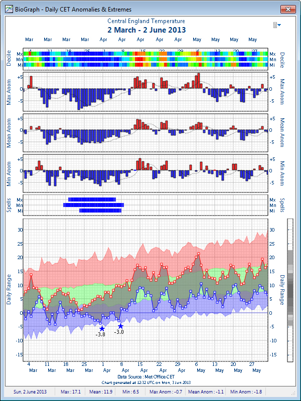

Why you rebuilt the trial version was to fixed the points problem - if you remember the center of the point wasn't being filled correctly. The good news is that is now fixed. The bad news is that all the lines are now fuzzy and not sharp AND the font problem is present I described above which all in all leaves a very poor unprofessional finish (see screenshot 2).

Regarding the lines, it sounds like you are using AntiAlias, isn't it? Note the latest version moved the default canvas from GDI to GDI+, that uses AntiAlias in the lines. If you want to try with GDI:
Chart1.Canvas:=TTeeCanvas3D.Create;

Good news - swapping to GDI fixed the problems with the font and the fuzzy lines!

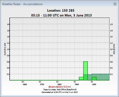

When working in the IDE I now get a completely distorted view of what I end up with at run time it's not WYSIWYG anymore (see screenshot). If I switched to using TeeChart 2013 in Delphi XE3 would that problem disappear?

You can change the default canvas to be GDI again. At design time, open the "Options" dialog in the contextual menu (right click on the chart), go to the last tab "New Chart". In this window, change the "Render" option from GDI+ to GDI. Close the menu and the IDE. From now on, the new charts should be created with GDI, as before.Metman wrote:Do I have to add that code to create a 3D canvas each time I use a TeeChart component or can I somehow switch to it at design time?
