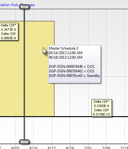

I currently have a TMarksTipTool and it pops up every time the mouse is anywhere on the chart (See popup 1).
However, it only updates (calls OnGetText) if the mouse is over actual data in the graph. (See popup 3).
Is there a way to make it so that the popup doesn't happen unless it is over a data item.
Or why does it not call OnGetText before it shows every time, instead of just when it is over new data?
- Updated when mouse is over the data
- popup3.png (19.19 KiB) Viewed 22420 times
- Tip not updated unless mouse move over item
- popup2.png (20.7 KiB) Viewed 22415 times
- Tips shown when not on graph data
- popup1.png (18.39 KiB) Viewed 22401 times

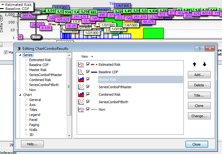

Re: Limit TMarksTipTool popup
There are several things in the cart. The one producing the bars is an Area.

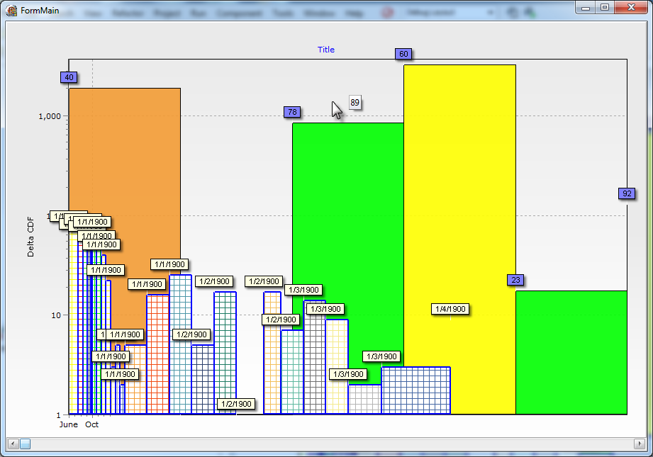

Here is a simple Form that has the problem.
It doesn't start showing the popup text right away, you have to scroll over a bar for a while first and then move back over the empty space.
It calls the GetText every time you go over a bar, but just displays the last one when you are over the empty area.

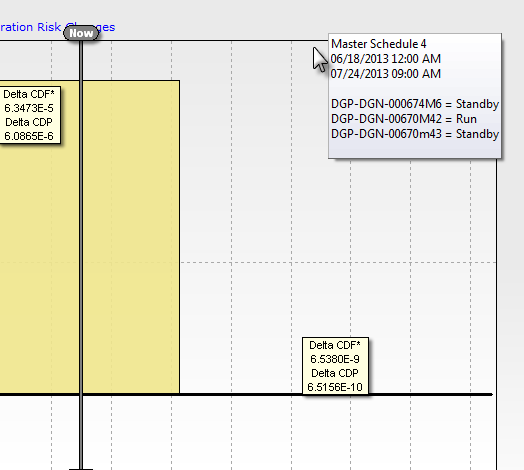

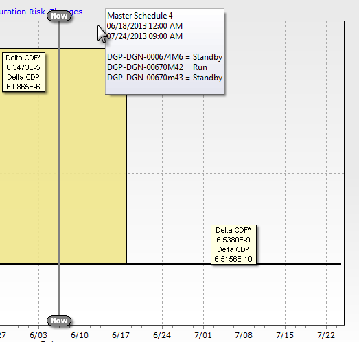

Still has issues for me.
(See pictures)
The # in the popup is the same.
It pops up when not on the bars.
I remembered we are a version behind because we had some conflicts with your latest version. Is this an issue that has already been fixed.
(See pictures)

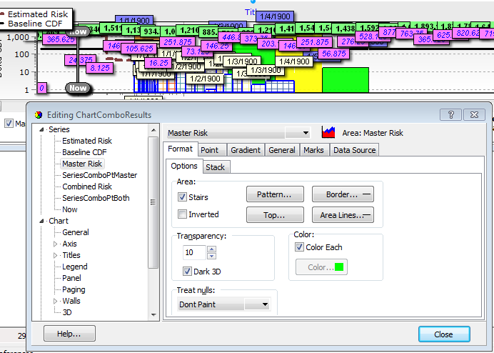

The issue is much simpler. It's just a problem of having 2 area series in a chart with an associated MarkTips tool each. You can reproduce it with the attached project. I think this is a bug and added it (TV52016624) to the defect list to be fixed for future releases. The solution is pretty simple though, you should just have a single MarkTips tool for all series, not associated to any particular series.
