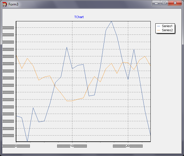

When I override the text that is displayed on vertical axis, through GetAxisLabel() function, only a bit of it is displayed on the actual graph.
Here's a picture to illustrate this:
In this project I just placed the chart on form, added two series and a custom GetAxisLabel() function that only adds a lot of brackets to labels:
void __fastcall TForm3::Chart1GetAxisLabel(TChartAxis *Sender,TChartSeries *Series, int ValueIndex, AnsiString &LabelText){
	LabelText=AnsiString("[[[[[[[[[[[[[[[")+LabelText+"]]]]]]]]]]]]]]]";
This happens for all label styles but Text. And Text style is not a solution for me because it only places one label per one series value on chart.
Is this a bug? Is there a workaround?

You could try to set a left margin to the chart, setting it to be the same size (a some pixels bigger) than the largest label in the axis.
Here it is a simple example, in Delphi:
uses Series, Math;
var maxLeftLabels: Integer;
  Chart1.View3D:=false;
  Chart1.AddSeries(TFastLineSeries).FillSampleValues;
procedure TForm1.Chart1GetAxisLabel(Sender: TChartAxis;
  Series: TChartSeries; ValueIndex: Integer; var LabelText: String);
  LabelText:='[[[[[[[[[[[[[[['+LabelText+']]]]]]]]]]]]]]]';
var i: Integer;
  maxLeftLabels:=-1;
  with Chart1.Axes.Left do
    Chart1.Canvas.AssignFont(LabelsFont);
    for i:=0 to Items.Count-1 do
      maxLeftLabels:=Max(maxLeftLabels, Chart1.Canvas.TextWidth(Items[i].Text));
  Chart1.MarginUnits:=muPixels;
  Chart1.MarginLeft:=maxLeftLabels;
