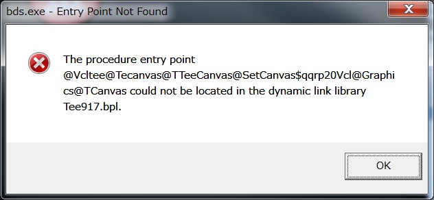

Greetings,
I installed TeeChart 2013 to RAD XE3.
But it did not work.
I became not to be able to start XE3 by to happen attached error.
Could you please teach me how to fix this problem?
Best regards,
Magic
installation problem of TeeChart 2013 for RAD XE3
- XE3 cannot start
- TeeChart2013RADXE3_Fault.jpg (45.25 KiB) Viewed 7602 times

Hi Magic,
This looks like your IDE has some path problems. I'd recommend you to clean/remove all old TeeChart package and path references and try installing the new version again.

Hello Narcis,
Thank you for response.
I uninstalled all TeeChart packages, and I reinstalled them.
But same problem happens.
This problem happens when reading the DclTeeMaker117.bpl package.
But this file exists in available path.
C:\Program Files (x86)\Steema Software\TeeChart 2013 for RAD XE3\Delphi17.win32\Bin

Hi Magic,
Please check that this path is on top of the list at Tools -> Options -> Environment Options -> Delphi Options -> Library -> Library path. Also check that no older TeeChart paths are on the list.Magic wrote: This problem happens when reading the DclTeeMaker117.bpl package.

Hello Narcis,
I added the library path at Delphi library path.
But same problem happened.
Also, I added the library path at C++ library path.

Hello Magic,
Did you add it on top of the search path list? This is important so that you can force this being the first path used?Magic wrote: I added the library path at Delphi library path.
Did you add \Lib\obj folder as well? Did you add \Include folder at the Include path list? Don't forget to move them on top of the list too.Magic wrote: Also, I added the library path at C++ library path.
