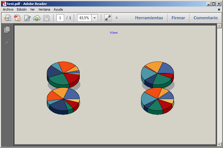

Are you using the latest version v2013.08?
I've made a simple example to try to reproduce it. Just place a Chart and two buttons in a form; and use the following code:
uses TeePDFCanvas, TeExport;
var i: Integer;
  Chart1.Legend.Visible:=false;
  for i:=0 to 3 do
    with Chart1.AddSeries(TPieSeries) do
      FillSampleValues;
      Marks.Visible:=false;
  TeeExport(Self, Chart1);
procedure TForm1.Button2Click(Sender: TObject);
  TeeSaveToPDFFile(Chart1, 'C:\tmp\test.pdf');
Then you have three ways to create a pdf:
- Click button1 to show the Export dialog. Select "as PDF" Format in the "Export\Picture" tab. Click the "Preview" button.
- Click button1 to show the Export dialog. Select "as PDF" Format in the "Export\Picture" tab. Click the "Save" button. Give a name to create the pdf file.
- Click button2.
I get a correct pdf following any of the three ways:
