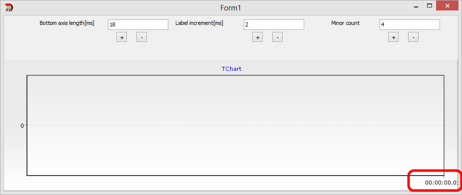

Problem with the bottom axis if its length is less than 20ms
Post by Jarek » Fri Aug 02, 2013 8:12 am
For bottom axis longer than 20ms label increment 5ms is ok. But for asix shorter than 20ms label increment 2 ms would be better. Unfortunately teechart shows only one label on the right side of the axis.
For asix shorter than 11ms label increment 1 ms would be better. Unfortunately teechart also shows only one label on the right side of the axis.
Thanks for any help you can give.
Jarek

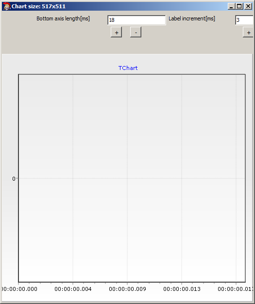

Re: Problem with the bottom axis if its length is less than 20ms
Post by Yeray » Tue Aug 06, 2013 10:31 am
I could reproduce the problem with your application so I've added it to the wish list to be revised for next releases (TV52016677).
Note if you resize the chart to less than 518 pixels width, the labels are correctly displayed:
Note I've added this to see the chart size:
void __fastcall TForm1::Chart1Resize(TObject *Sender)
	Caption = "Chart size: " + IntToStr(Chart1->Width) + "x" + IntToStr(Chart1->Height);
So there seems to be a number of variables here affecting this.
