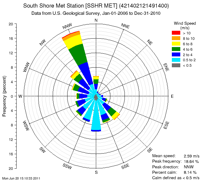

Is producing something like this possible in the latest version of TeeChart?
Bruce.
Thanks for that I've now got it working!
Bruce.
- example_wind_rose.png (29.22 KiB) Viewed 7133 times

Hi Metman,
Yes, this is possible with TRoseSeries, new in the latest TeeChart Pro version. You'll find an example at What's New?\Welcome!\New Series\Rose in the features demo, available at TeeChart's program group with both evaluation and registered version. Fully functional evaluation version can be downloaded here.
