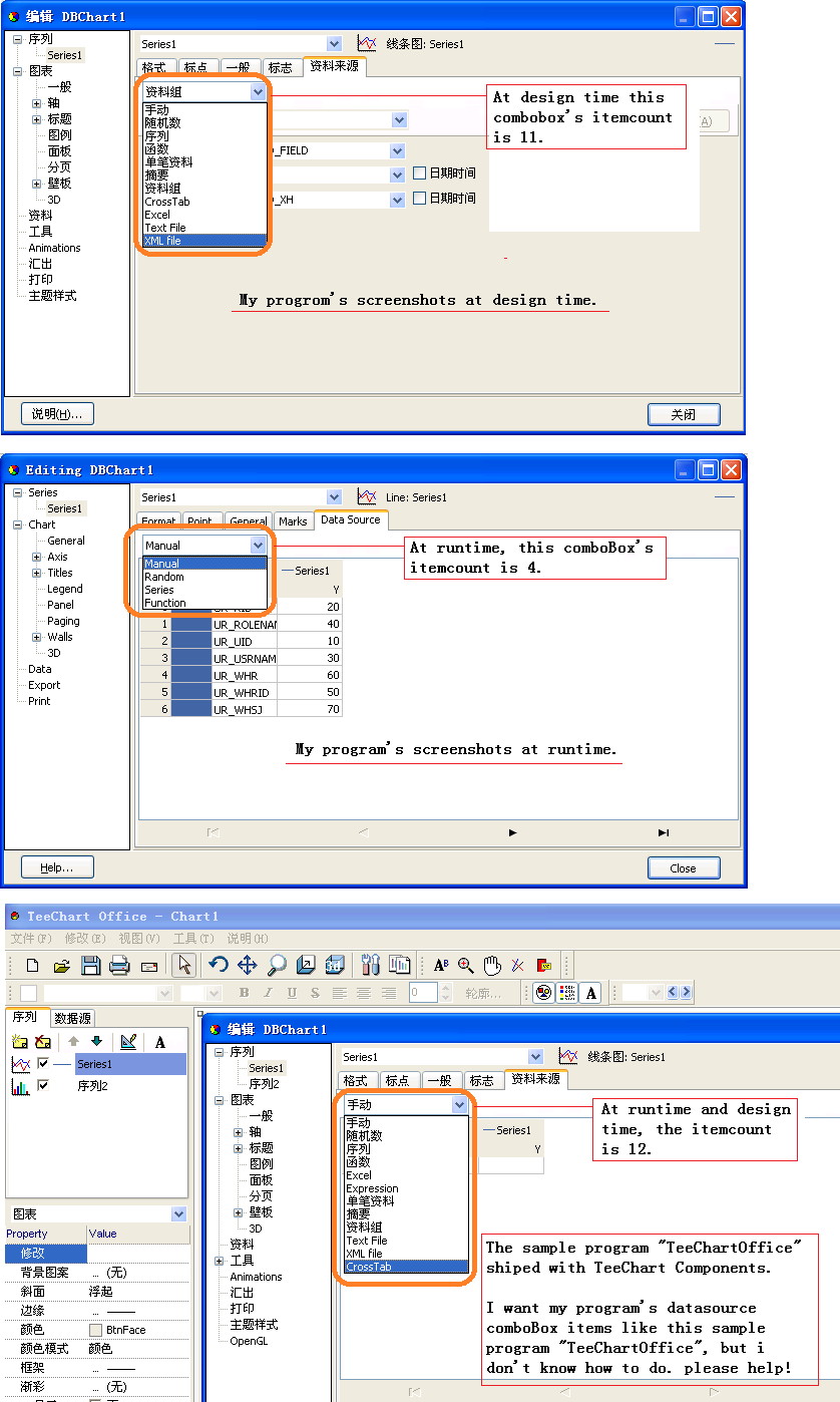

why is my datasource combobox's item only 4 ?
Post by weichangmei » Tue Aug 20, 2013 1:51 pm
My progrom's screenshots at design time.
My program's screenshots at runtime.
The sample program "TeeChartOffice" shiped with TeeChart Components.
i want my program's datasource comboBox items like the sample program "TeeChartOffice", how to do ?

Re: why is my datasource combobox's item only 4 ?
Post by Yeray » Wed Aug 21, 2013 3:38 pm
I can't see the screenshots, can you please correct the links?
Also, TeeChartOffice sources are shipped with the binary version. Find them at the "\Examples\TeeChartOffice\Sources" folder in your TeeChart installation.
Post by weichangmei » Wed Aug 21, 2013 4:37 pm
please look the attachment.
screenshots
00 screenshots.png (106.9 KiB) Viewed 6091 times
Post by Yeray » Thu Aug 22, 2013 7:41 am
You just have to add some units to the uses clause:
uses TeeDBSumEdit, TeeDBSourceEditor, DBEditCh, TeeDBCrossTab, TeeExcelSource, TeeSeriesTextEd, TeeXML;
If you also want to add the TeeExpression unit, note it's shipped with the TeeChartOffice example, at "\Examples\TeeChartOffice\Sources"
