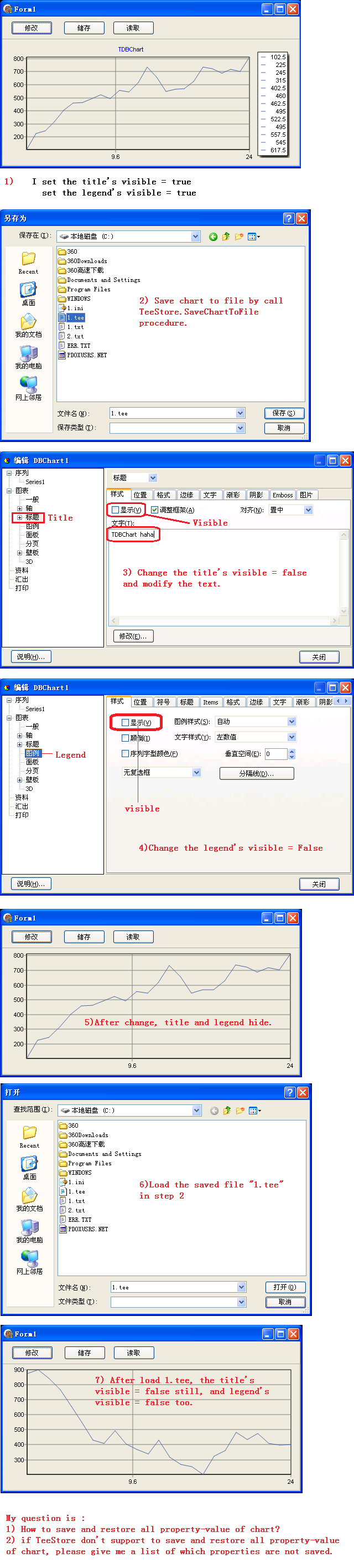

hi, i want to save chart's property-value by TeeStore.SaveChartToFile and restore property-value by TeeStore.LoadChartFromFile,
but, Only some property-value are stored.
+++++++++ My Test Step begin ++++++++
Step 1: Run the program, the title's visible is true, and the legend's visible is true.
Step 2: Save the chart to file "c:\1.tee"
Step 3: Change title's visible to false
Step 4: Change legend's visible to false
Step 5: Load chart from file "c:\1.tee"
Now the title's visible is still false, and the legend's visible still false.
------------- My Test Step end --------------
My question is :
1) How to save and restore all property-value of chart?
2) if TeeStore don't support to save and restore all property-value of chart, please give me a list of which properties are not saved.

Re: Don't TeeStore.SaveChartToFile save all property-value ?
Post by Yeray » Tue Aug 27, 2013 3:22 pm
This is because, when you load the tee file, you are loading it over a chart with a hidden legend and title instead of over an "empty" chart.
Note that the tee file only stores those properties that don't have the default value. This produces smaller tee files, but needs empty charts to load the tee files, just as in the Tutorial 12. Ie:
procedure TForm1.btnLoadClick(Sender: TObject);
var tmpChart : TCustomChart;
  DBChart1.Free;
  tmpChart:=TDBChart.Create(Self);
  With OpenDialog1 do
    Filter:= 'Teefiles|*.tee';
    if Execute then
       LoadChartfromFile(tmpChart, OpenDialog1.FileName);
  DBChart1:=tmpChart as TDBChart;
  DBChart1.Parent:=Self;
