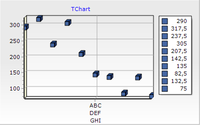

This is how it looks with v2013.08:

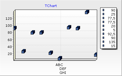

And this is how the same example looks with the actual sources (and with the beta) we have here:
So it should be fixed with the next maintenance release.
