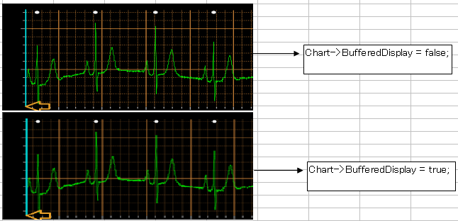

When I set the BufferedDisplay property as true,
Why the wave wasn't drawed clearly?
Please find the attachment.
- BufferedDisplay.png (38.36 KiB) Viewed 15107 times

That's not what we would expect. Could you please send us a simple example project we can run "as-is" to reproduce the problem here?

This looks like a Firemonkey for C++ Builder bug as I can not reproduce it with a Delphi HD Firemonkey application, which I attach. Could you please add it to bugzilla? Doing so you'll be identified as the creator of the issue and therefore notified about its evolution.

He suggests us to change TScaledLayout to TLayout..which we tried before.
But as a known TScrollPage tool bug, when it is resized,
it needs to remove series of TScrollPage tool, and assign series to it again.
We are afraid that it will slows down the speed by repainting again and again
whenever the form is resized, so we are using the TScaledLayout instead of TLayout
to contain TChart to avoid it resized every time.
