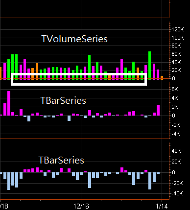

When multiple series are used and a TVolumeSeries is placed in the middle of chart, it will paint below zero.
This won't happen if It is replaced with TBarSeries. Please help, thanks!

Try setting the TVolumeSeries' UseYOrigin and YOrigin properties:
myVolumeSeries.UseYOrigin:=True;
myVolumeSeries.YOrigin:=0;
