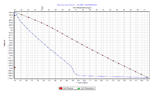

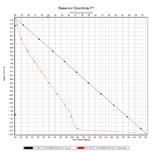

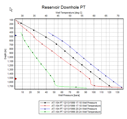

With TeeChart 8, the symbol size in the legend of line graphs matched the symbol size used in the graph, up to a maximum 5x5 symbol. See the attached images tagged with TeeChart8. With TeeChart 2013, however, the symbol size is always at one large size and very wide, especially for our multiple graphs (see images tagged with TeeChart2013). I tracked the cause of the problem down to a change in the parameters for the Pointer.DrawPointer command in TeePointerDrawLegend in series.pas.
When I replaced this with the parameters fromTeeChart8, the legend symbol is now drawn correctly. Will Steema restore the DrawPointer parameters to those in TeeChart 8, or do I have to write some overloaded procedure in my code to obtain the output I require. If the latter, can you please indicate where I would need to introduce the overloaded procedure as the TeePointerDrawLegend is deep within the TeeChart code.

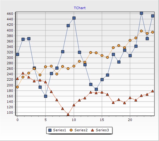

Errol wrote:Yes this looks similar to what I expect, except I would like to also see the line colour and line type in the legend as a line through the symbol (usually shorter than that shown in MultipleGraph_TeeChart8.png - our Multiple Graph legends are coded). I'll stay with the Source Code change at the moment until your maintenance release comes out, and then see if I have to develop an override version of TeePointerDrawLegend.
Note you can widen the legend symbol through the Legend.Symbol.Width property. Ie:
uses Series;
var i: Integer;
  Chart1.View3D:=false;
  for i:=0 to 2 do
    with Chart1.AddSeries(TLineSeries) as TLineSeries do
      FillSampleValues;
      Pointer.Visible:=true;
      Pointer.Style:=TSeriesPointerStyle(i);
  Chart1.Legend.Alignment:=laBottom;
  Chart1.Legend.Symbol.Width:=50;
