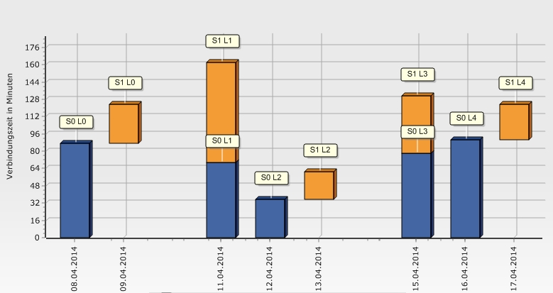

The data i want to use for the bars are only at some points identical, so i try to use mbStacked.
But if i have some values which are unique the bars are "up in the air" :wink: .
The result looks like this.
Any Ideas what i am doing wrong?

This happens because the stacked is based on the value indexes.
You could loop your series & values and, if the other series don't have any value at a given XValue, add a null point there. Ie:
    for j:=0 to Chart1[i].Count-1 do
      for t:=0 to Chart1.SeriesCount-1 do
        if i<>t then
          found:=false;
          for w:=0 to Chart1[t].Count-1 do
            if Chart1[i].XValue[j]=Chart1[t].XValue[w] then
              found:=true;
              break;
          if not found then
            Chart1[t].AddNullXY(Chart1[i].XValue[j], 0);

Post by Kai » Wed Apr 09, 2014 11:48 am
works perfect. Thank you.
