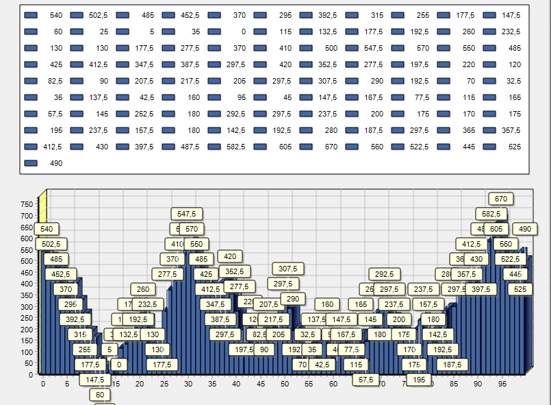

I use the follwing to create a large TBarSeries series Series1.FillSampleValues(100);
The result looks like this:
Is it possible the set a fixed height for the legend and use a custom scrollbar?

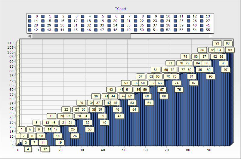

TeeChart Pro includes the TLegendScrollBar between the Chart Tools.
Here you have an example of it:
uses Series, TeeLegendScrollBar;
var i: Integer;
  with Chart1.AddSeries(TBarSeries) do
    for i:=0 to 99 do
      Add(i);
  Chart1.Legend.Alignment:=laTop;
  Chart1.Tools.Add(TLegendScrollBar);
  Chart1.Legend.MaxNumRows:=4;
Note this tool is designed for the default vertical Legend Alignment (aka laLeft/laRight). In an horizontal Alignment (aka alTop/alBottom), when you increment the position of the scrollbar a unit, the top-left element of the legend disappears, all the other elements move a step left (the elements on the left move a row above and to the right edge), and a new element appears on the right-bottom.
This may be better explained with two images.
Here it is how it looks when you start the application running the code above:
And this is how it looks if you press the right arrow on the legend scrollbar once:
The alternative would be draw your shapes and texts manually at OnAfterDraw event.

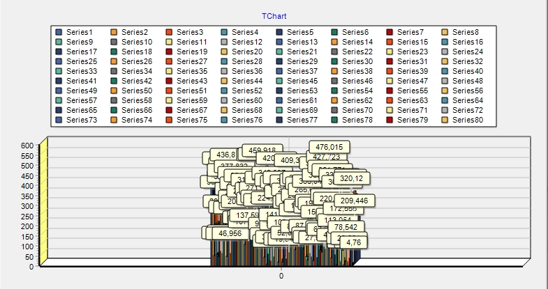

If i use something like that:
var
  intI: Integer;
  ChartAccounting.Legend.Alignment := laTop;
  for intI := 0 to 100 do
    with frmChart.ChartAccounting.AddSeries(TBarSeries) as TBarSeries do
      FillSampleValues(1);
  frmChart.ChartAccounting.Draw();
It looks like that:
So the problem is that there are missing series in the legend.
How can i solve this? Thanx.

Kai wrote:So the problem is that there are missing series in the legend.
If you don't specify the Legend's MaxNumRows, the maximum number of rows will be 10. In the case above, to fit 101 items you'll need 21 rows:
ChartAccounting.Legend.MaxNumRows:=21;
