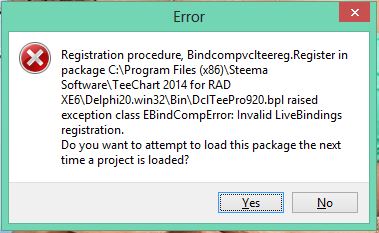

I have run and tried to install the package downloaded from the Client Access section for Steema TeeChart 2014 for RAD Studio XE6.
Everything appeared to installed without error however once I start Delphi XE6 or RAD Studio XE6 I get an error message which I have uploaded as an attachment.
Any clues as to what's happened here ?

Are you running a limited version of RAD Studio like Starter edition? Maybe your IDE doesn't have LiveBindings.
Alternatively maybe you ran the installer or you are running the IDE without enough privileges to register the required packages.
