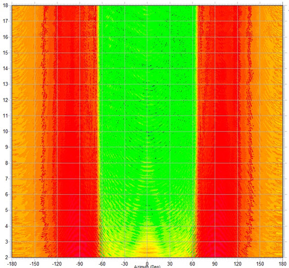

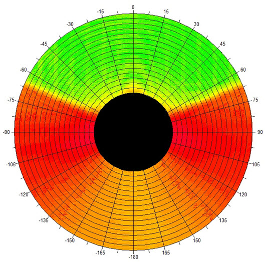

I am trying to create a chart that is sort of a cross between a polar plot and a color grid. Is this possible?
It would look like this...
It was created from a TColorGridSeries that Looks like this...
Re: Polar Series
Post by Narcís » Thu Jul 17, 2014 1:08 pm
Hi dpatch,
Sure! There's a specific series for that, the PolarGrid series? You can find an example at All Features\Welcome!\Chart Styles\Extended\Polar Grid.

I am looking at it now. Is there a way to leave the center empty/transparent (as shown above), or even display a BMP in it? I do not want the inside pixels so close together. Thanks.
Re: Polar Series
Post by Narcís » Fri Jul 18, 2014 8:13 am
Hi dpatch,
Casually, this is the same we discussed here a couple of days ago. PolarGrid series also has DrawZone method. However, it's also affected by ID850. Please feel free to sign up at bugzilla and add yourself to the CC List to receive bug update notifications.

If you're using a PolarGridSeries, can't you just not fill the inner cells? That would certainly make some Kind of a "hole" in there.
Also, placing something like a Bitmap in the centre of the polar diagram sounds appealing. Currently, I would not know how to best place some VCL component like a TPanel or TImage there so that it won't overlap with the diagram and only "fills" the hole.

jens.mertelmeyer wrote:If you're using a PolarGridSeries, can't you just not fill the inner cells? That would certainly make some Kind of a "hole" in there.
Yes, you are right. You could set those cells to null not to be painted, for example:
var Sector, Track : Integer;
    tmp     : TChartValue;
    index   : Integer;
  with Series1 do
    Clear;
    CircleLabels:=True;
    RadiusIncrement:=1;
    NumSectors:=15;
    NumTracks:=10;
    BeginUpdate;
    for Sector:=0 to NumSectors-1 do
        for Track:=0 to NumTracks-1 do
          tmp:=0.5*Sqr(Cos(Sector/(NumSectors*0.2)))+
                   Sqr(Cos(Track/(NumTracks*0.2)))-
                   Cos(Track/(NumTracks*0.5));
          index:=AddCell(Sector,Track,tmp);
          if Track < 5 then
            SetNull(index);
    EndUpdate;
    AngleIncrement:=360/NumSectors;
jens.mertelmeyer wrote:Also, placing something like a Bitmap in the centre of the polar diagram sounds appealing. Currently, I would not know how to best place some VCL component like a TPanel or TImage there so that it won't overlap with the diagram and only "fills" the hole.
It might be easier drawing an image in the chart canvas using its Draw or StretchDraw methods. The most difficult part would be calculating the exact image size and location.
