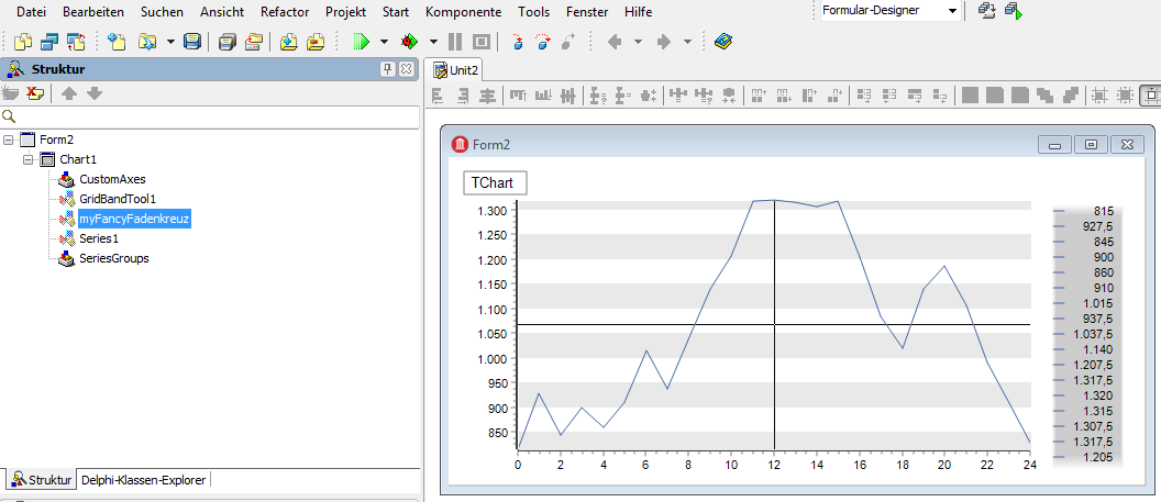

I'm confused. The cursor tool is a regular component, just like the chart itself, a button or whatever. You can rename it to whatever you like:
This also enables you to use this reference in code (like "myFancyFadenkreuz.Active := checkItsRainingOutside();") without having to introduce another variable or do any casting.

I tried it in a function where I wanted to send both the cursors to.
like:
procedure MyDrawingToolUnit . MySynchronizeGenie(cursor1,cursor2);
Did not work for me, because I could not ADRESS my crosshairs "anytime at runtime".
So: This was the beginning of "our story" / thread.
If you need some code example, please look at the source codes and screenshots of the old thread.
For the "new" problem, I do not have an example.
If I had it, there would be not need to ask for it any more.
Thank you for having read down to here.
Cheryll
