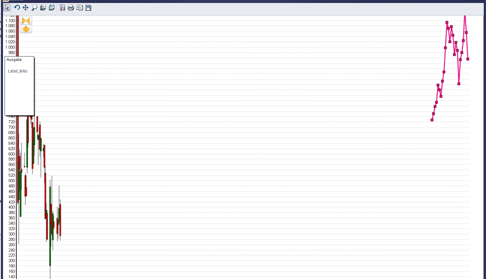

I have a Chart with 2 Series.
Both series have the same bottom axis, which is a date.
One series is of the Type CandleSeries and the other one LineSeries.

The moment I use 2 loops:
for i...to...
SeriesCandle.AddCandle(date,...)
and:
for i...to...
SeriesLine.Addxy(date,...)
It does not work any more as intended.
To my mind, this is due to the fact, that the date series comes in sorted, but in 2 CLUSTERS.
The candle data has e.g. the date from the 1st of April to the 1st of October.
Then the line series starts again by the 1st of April.
This is not the case, if I have ONE loop.
How can I make these 2 series to MELT on the bottom-date axis?
Only the y-values shall differ and have 2 axis.
The x-value shall be the same and show my 2 values at the same day if it occurs to have a common day.

I attach you a screenshot, how it shall NOT look alike.

To have same DateTime in the both loops is necessary reset the DateTime before add data to second series. Using the simple code below the problem you experiencing doesn’t appear for us here.
uses System.DateUtils, TeCanvas;
var date: TDateTime;
var i:Integer;
tmpOpen,tmpClose: Double;
Chart1.View3D := false;
    //Date
    date := Now;
    tmpOpen := Random(1000);
    Series2.XValues.DateTime := true;
    for i := 0 to 30 do
      tmpOpen :=tmpOpen+(Random(100)-50);
      tmpClose:=tmpOpen-(Random(100)-50);
      Series1.AddCandle( date, tmpOpen, tmpOpen+Random(10), tmpClose-Random(10), tmpClose );
      date := IncDay(date,5);
    //Reset Date to Now.
    date := Now;
    for i := 0 to 30 do
     Series2.AddXY(date,Random(100));
Could you please check the code and tell us if it works in your end?

thank you very much for the answer.
The good new: It works!
The strange news: I did nothing.
To work on with my software in the meanwhile, I deactivated the "critical series".
On displaying it again - suddenly the thing was fixed.
I did not touch the 2 functions, which add my 2 series!
Since yesterday I tried to get the misfunction again to report you-, but no, it works now.
However I had this 2-series-problem douzends of time in the last years and used ugly work-arounds.
So I will keep the solution saved and trust, it saves me the rainy day, when I see it again. Thanks!
