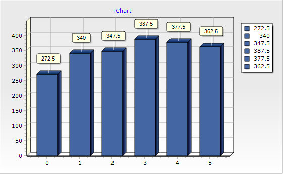

If I just create a TBarSeries,
uses Series;
  Chart1.AddSeries(TBarSeries).FillSampleValues();
it looks fine to me:
So I guess you have set some property in the bottom axis that is cutting it.

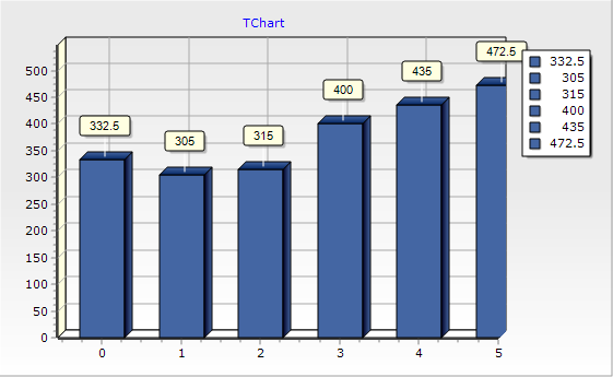

Ie, if I set a maximum in the bottom axis:
  Chart1.Axes.Bottom.AutomaticMaximum:=False;
  Chart1.Axes.Bottom.Maximum:=5;
If we force the axis maximum as above, then the chart isn't adding any extra margin to fit the bar width:
In that case, you can use MaximumOffset property to manually set an extra margin and avoid that:
  Chart1.Axes.Bottom.MaximumOffset:=35;
