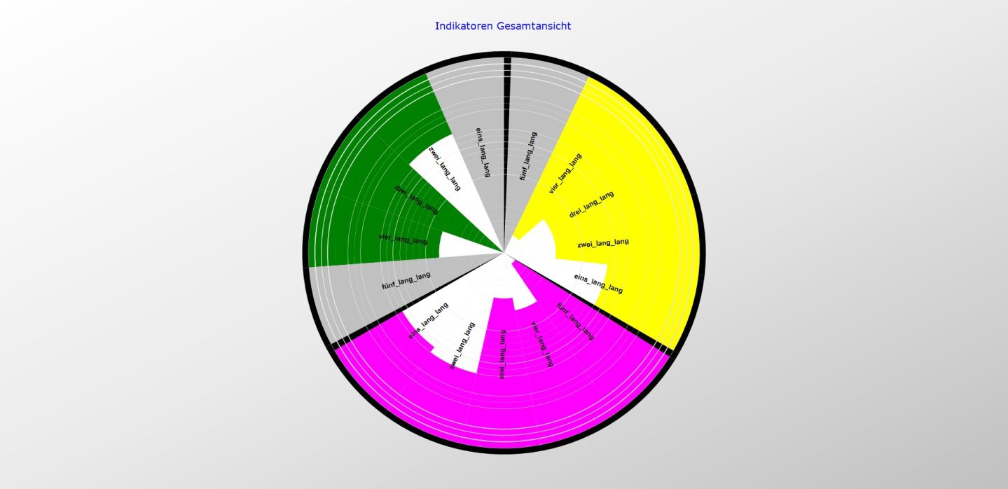

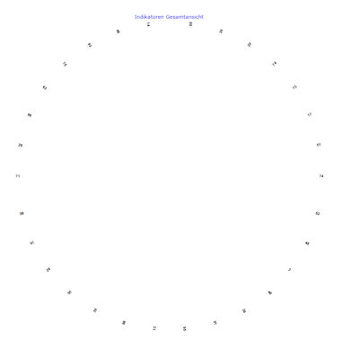

I try to export a TeeChart to a pdf-file. The chart is from the template gallerie, the Concentric Donuts.
After export, the chart is screwed-up.
At the pdf-file, there are only the marks from the chart but no chart.
Please can you help me?

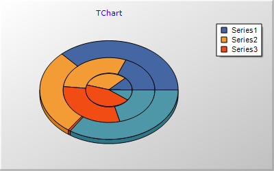

The concentric Donuts Template doesn't look as the one you posted above for me here.
Here it is how it looks for me:
And here it is the pdf I get with this code:
uses Series, TeePDFCanvas;
var i: Integer;
  Chart1.Title.Caption:='Concentric Donuts';
  for i:=0 to 2 do
    with Chart1.AddSeries(TPieSeries) as TPieSeries do
      FillSampleValues(4);
      Marks.Hide;
      MultiPie:=mpConcentric;
  TeeSaveToPDFFile(Chart1, 'C:\tmp\Chart1.pdf');

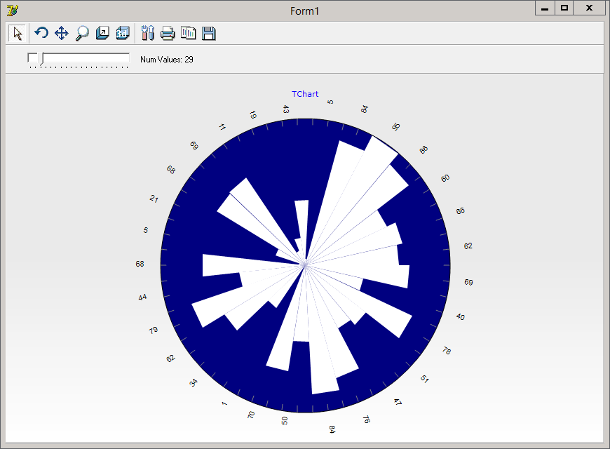

Yeray wrote:I've been trying to do a demo using the Rose series. I found some issues but I one problem I can't find how to workaround: some circle labels seem not to be drawn depending on the number of values.
I've corrected the example above and this seems to work better.
Exporting to a pdf file works better than with the TPieSeries, but not perfect: the labels in the main chart disappear. However, printing the chart with a virtual pdf printer also works fine:

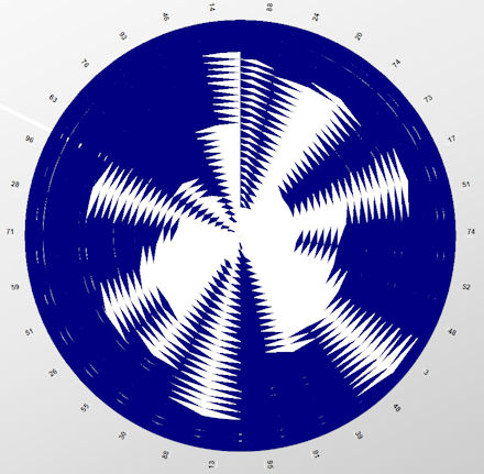

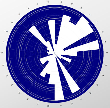

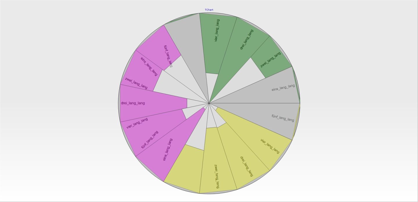

the rose serie has a cleaner look then the concentric donuts. But I have one Problem. I like to put the labels inside the circle, to save some space around the chart. If the labels-text get a bit longer then 3 numbers, the labels on the left side are not symmetric positioned to the labels on the right side:
The labels loose the assignment to its chart-values.
If I put the marks at the concentric donuts inside the circle, I nearly get a circle:
Each segment get its right label.
Is there an option at the rose serie, to position the labels in the circle without loosing the assignment to the values?
Best regards
Peter
