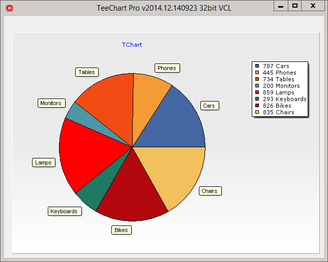

I've made a simple example with C++Builder XE7 and TeeChart Pro v2014.12 trying to reproduce this:
void __fastcall TForm1::FormCreate(TObject *Sender)
  this->Caption = TeeMsg_Version;
  TTeeCanvas3D * teeCanvas3D = new TTeeCanvas3D();
  Chart1->Canvas=teeCanvas3D;
  Chart1->View3D=false;
  TPieSeries * pie1 = new TPieSeries(Chart1);
  Chart1->AddSeries(pie1);
  pie1->FillSampleValues();
  int maxIndex = 0;
  for (int i=1; i<pie1->Count(); i++)
	if (pie1->YValue[i]>pie1->YValue[maxIndex])
	  maxIndex = i;
  pie1->ValueColor[maxIndex]=clRed;
But the result looks correct to me:
Please, try to arrange a simple example project we can run as-is to reproduce the problem here.
