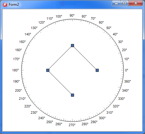

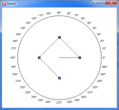

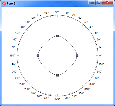

I'm having trouble with the TPolarSeries.
Consider this simple chart with two TPolarSeries:
	chart1.Axes.Left.SetMinMax(0.0, 20.0);
	chart1.Axes.Bottom.SetMinMax(0.0, 20.0);
	Series1.AddPolar(0.0, 10.0);
	Series1.AddPolar(90.0, 10.0);
	Series1.AddPolar(180.0, 10.0);
	Series1.AddPolar(270.0, 10.0);
Please have a look at how this chart is displayed in regard to Draw Style:
Draw Style: Curve
Draw Style - Curve.png (36.66 KiB) Viewed 21155 times
Draw Style: All
Draw Style - All.png (36.4 KiB) Viewed 21142 times
Draw Style: Segments
Draw Style - Segments.png (41.57 KiB) Viewed 21132 times
You can already see that there is something wrong about the "Segments" draw style.

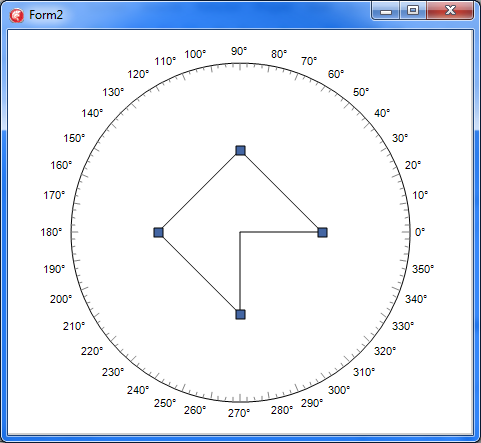

It gets even more interesting when we set "Close Circle" to False:
Draw Style: Segments. Close Circle: False
Draw Style - Segments, Don't close circle.png (37.36 KiB) Viewed 21115 times
What is that invisible point in the center used for? Can I somehow circumvent having lines to the centre? You might want to say "Sure, just don't use the Segments draw style". The problem is that the TSeriesBand tool somehow uses a segment draw mode of the underlying series so that you're getting weird stuff when using a series band between two polar series:
Is there a suggested workaround for this?

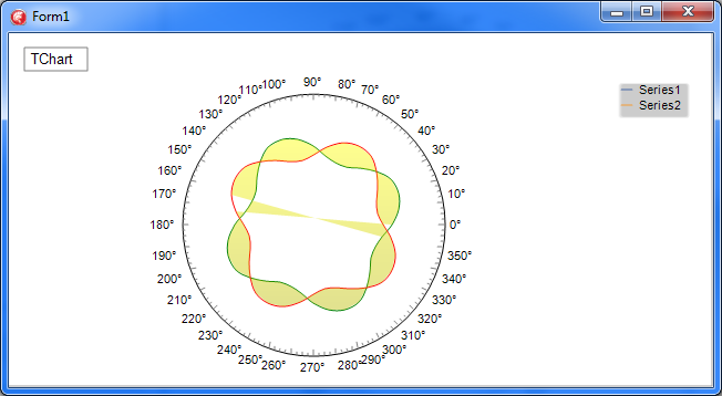

I found out that the anomaly shown in the last picture actually hails from a different "RotationAngle" of both series. If both series have the same rotation angle, then everything looks pretty good. I will try to provide a minimal example for tomorrow about what you can easily trip over when using a TSeriesBandTool for two TPolarSeries.
jens.mertelmeyer
Posts: 60
Joined: Fri Nov 22, 2013 12:00 am
Re: TPolarSeries: Invisible Point at (0,0)
Post by jens.mertelmeyer » Fri Oct 10, 2014 7:26 am

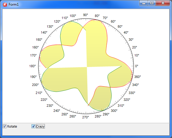

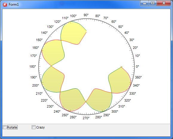

This is more like a reminder to self about caveats when using a TSeriesBandTool on polar series:
When using a TSeriesBandTool on two TPolarSeries objects, make sure both share the same value for the property RotationAngle. When calling Rotate(Integer) on a TPolarSeries, also call Rotate(Integer) for the same value on the other series.
If you want to rotate a TPolarSeries that's used in a series band, you will have to redraw the series yourself.
Hint: If you just want to rotate the "grid" (axis labels) of a polar series, the easiest thing would probably be using an empty polar series and use the RotionAngle-property of that series. Make sure this series is the chart's first series.
Attached you find a small demo of two polar series rotating against each other. Tick the checkbox labelled "crazy" to show what happens if you lazily use the RotationAngle property instead of repainting the series.
How to do it
How to do it.png (49.38 KiB) Viewed 21097 times
How not to do it
How not to do it.png (53.21 KiB) Viewed 21095 times
Hope this might prove helpful in case somebody also stumbles upon this problem.
