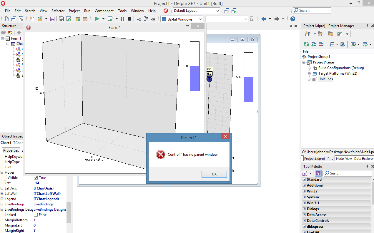

Re: Bug with TLegendPalette?
I open the project file I sent you, run it and move the mouse over the chart and the error appears, we use the same TChart version (mine is 32 bit under Windows 8.1 64 bit).
- Untitled.png (72.55 KiB) Viewed 60670 times

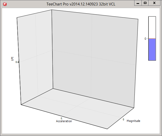

Same environment here: Windows 8.1 64 bit, RAD XE7 and TeeChart Pro v2014.12 binary.
Could this be caused due to some modification you may have done to the sources? Have you tried with the binary v2014.12?
I've added this to your project to check the TeeChart version being used:
And I can move the mouse around without any problem.
However, using SeriesList.FillSampleValues() I get an Exception after rotating the chart depending on the Rotation set, but this doesn't look as the error you are reporting:
uses VCLTee.TeeConst;
Caption:=TeeMsg_Version;
//Chart1.SeriesList.FillSampleValues();
Project Project1.exe raised exception class $C0000005 with message 'access violation at 0x0076a451: read of address 0xffffffe8'.

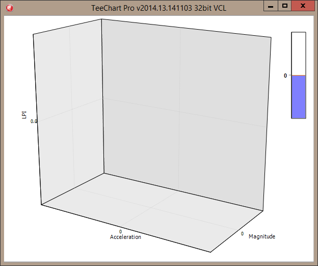

My version is 'TeeChart Pro v2014.12.140923 32bit VCL, you are using 2014.13?
Hi!
Sorry, I tested it with different versions and made the screenshot with the internal sources we have here
I made the screenshot with our current sources, but I haven't been able to reproduce the problem with v2014.12 either.
I'm sorry for the confusion generated.Narcís wrote:Yeray is out of the office today. However, I understand that he couldn't reproduce that with our current sources. That would mean you can expect the problem being fixed for the next maintenance release.

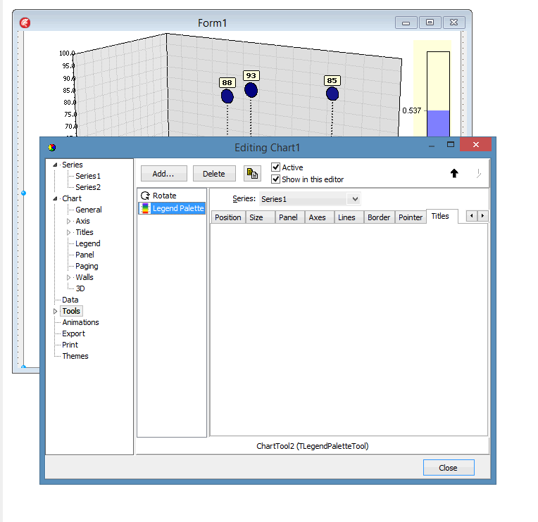

When I try to see the properties of TLegendPalette I get an empty Titles page
- Screenshot 2014-11-11 22.32.gif (29.37 KiB) Viewed 60584 times

#3. Empty titles tab in Legend Palette editor.
I see this happens the first time you open that tab. If you change to another tab and you reopen the Titles tab, then it's shown correctly.
I've added it to the public tracker too:
http://bugs.teechart.net/show_bug.cgi?id=1003

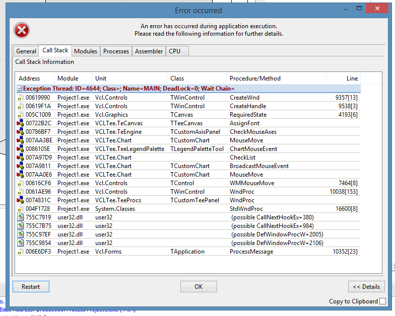

.. here is a screenshot when I enable EurekaLog, if it can be of any help
- Screenshot 2014-11-12 19.58.gif (39.5 KiB) Viewed 60556 times
Even if we can't reproduce the problem, looking at the Call Stack and debugging the application here I guess disabling Hover should skip the problem you are reproducing. Note TCustomAxisPanel.CheckMouseAxes funcion only does something when Hover is Visible:
I'm afraid we can't suggest much more without being able to reproduce the problem here.
I assume this is referencing the #1 in my last post.johnnix wrote:.. here is a screenshot when I enable EurekaLog, if it can be of any help
