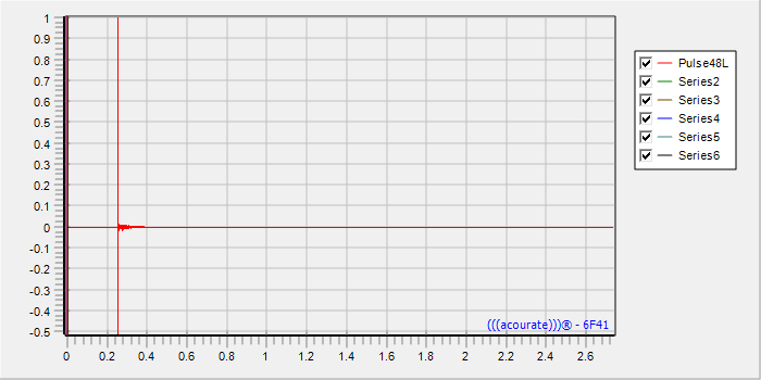

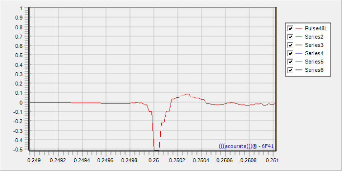

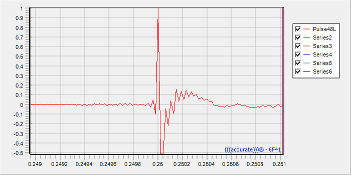

My problem is that the chart must allow zooming. With DrawAllPoints:=false a series is quickly drawn. But then with zoom I get a wrong display.
See an example with not too many points (justabout 65000 points):
First the plot with all points with/without DrawAllPoints:
Now with zoom
Obviously the last chart is wrong.
So this means that the quick chart is drawn by throwing away the points. With zoom the points are still gone.
Another approach would be to keep all the points but only to plot points with a different X pixel (in case of minmax two points may be drawn at the X position). Then with zoom the points need to get re-calculated again using only the data in the X range but applying the same approach of "pixel reduction".
Would that be possible?
- Uli

I guess I made a wrong conclusion.
The first picture show the high amplitudes. So the data points are there.
But in the zoomed picture the high amplitudes disappear, despite DrawAllPointsStyle := daMinMax;
So it seems that with DrawAllPoints switched off DrawAllPointsStyle is no longer in use and thus it may be the reason for the missed high amplitude.
- Uli

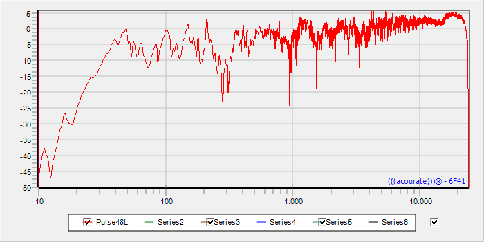

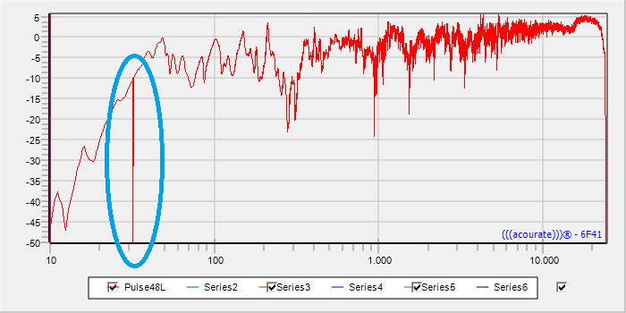

Yesterday I have got a test version of Series.pas by Narcís.
It solves the problem described by the example code but creates another problem.
See an example of a frequency plot with 65537 points.
With DrawAllPoints = false the chart shows artifacts, see marked area
With DrawAllPoints = true the chart looks ok
Uli
PS: please see also the wong legend display. I start another topic about this
