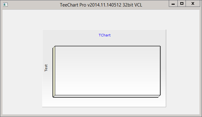

I setup a chart to use multiple lines on the left axis--but it is not working.
For example, in an otherwise new project with a TChart on the form, the following LOC:
Chart1.LeftAxis.Title.Caption := 'Test'#13'This'
Will only show "Test" on the left axis.
Is there anyway to get that to work? I looked at various left axis .title properties and didn't see anything there.

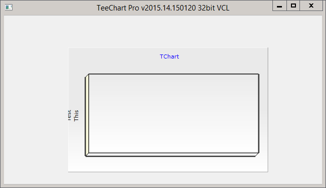

Re: left axis does not allow for multiple lines
Post by Yeray » Tue Jan 27, 2015 9:04 am
Hi Ed,
I could reproduce the problem with v2014.11 but it seems to work fine with v2015.14:
Post by TestAlways » Tue Jan 27, 2015 3:14 pm
Thank you. Yes, it does work correctly in 2015.14. Thank you.
