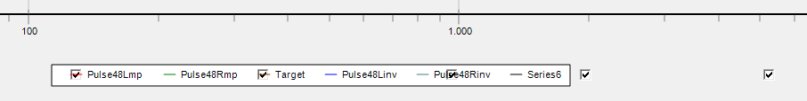

Actually I get a wrong display when showing the legend at the bottom
Placing the legend at the right side gives a correct result
- Uli

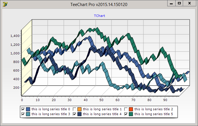

I'm very sorry but the bottom legend is still wrong.
I need to use a legend with checkboxes.
In my own program I get now the legend displayed correctly but get a wrong behaviour. So a click on some checkboxes switches on/off the wrong series. To switch on/off a desired series I need to click beside a checkbox in the legend text. This means that the mouse position is not calculated correctly.
As it is difficult to send the full source code I have tried to make an example. The example also behaves wrongly but a bit different (some checkboxes are missed but you can click also on the text). Anyway you can see a malfunction and check what's wrong.
So simply drop a TChart component on a project form and run
var i: integer;
    SeriesArray: array[0..5] of TChartSeries;
  Form1.Width := 800;
  Form1.Height := 400;
  Chart1.Legend.CheckBoxes := true;
  for i := 0 to High(SeriesArray) do
    SeriesArray[i] := TLineSeries.Create(Chart1);
    SeriesArray[i].FillSampleValues(100);
  Chart1.AddSeries(SeriesArray);
  for i := 0 to 5 do
    Chart1.Series[i].Title := 'this is long series title '+IntToStr(i);
As I like to deploy a correct version of my program a quick fixup would be very appreciated.
- Uli

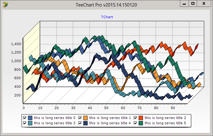

Re: Wrond legend display with 2015.14 update
Post by Yeray » Mon Feb 02, 2015 3:47 pm
Hi Uli,
I've tried this with both v2015.14 and with the current internal sources we have here and it seems to work fine in both:
Here it is the project I used:
testBottomLegendCheckboxes.zip
(1.67 KiB) Downloaded 1517 times
Am I missing anything?

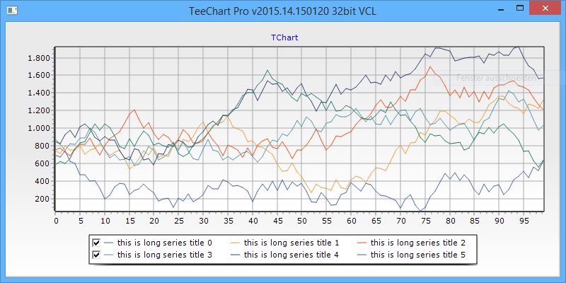

Post by ulibru » Thu Feb 05, 2015 9:00 am
Hello Yeray,
I have downloaded your test project testBottomLegendCheckboxes.zip
Indeed it works with 3D display. BUT please switch 3D off and you get
Uli

Post by Tracey » Sun Feb 08, 2015 5:39 pm
hi yeray:
thanks for the TeeChart Pro BETA installer for XE7. it fixed the misalignment problem.
however now on plots where the legend is more than one row, the checkboxes in all but the first column are not visible, similar to what was reported by uli above. i am also using 2D plots.
thanks!
Tracey
Post by Yeray » Mon Feb 09, 2015 1:44 pm
Hello Uli and Tracey,
You are right the change I proposed doesn't seem to fix this in some circumstances.
I've reopened the ticket so it can be reviewed:
http://bugs.teechart.net/show_bug.cgi?id=1030
