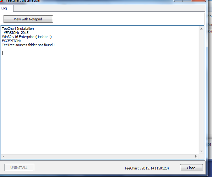

For info, while proceeding with the installation, I got an error message about the TeeTree source missing (see the snapshot). Shall I worry about it?

This is a known problem we've already fixed for the next maintenance release. In the meanwhile, if you don't use TeeTree I'd just check the paths and the list of packages ans mentioned above.cssesuc wrote:For info, while proceeding with the installation, I got an error message about the TeeTree source missing (see the snapshot). Shall I worry about it?
