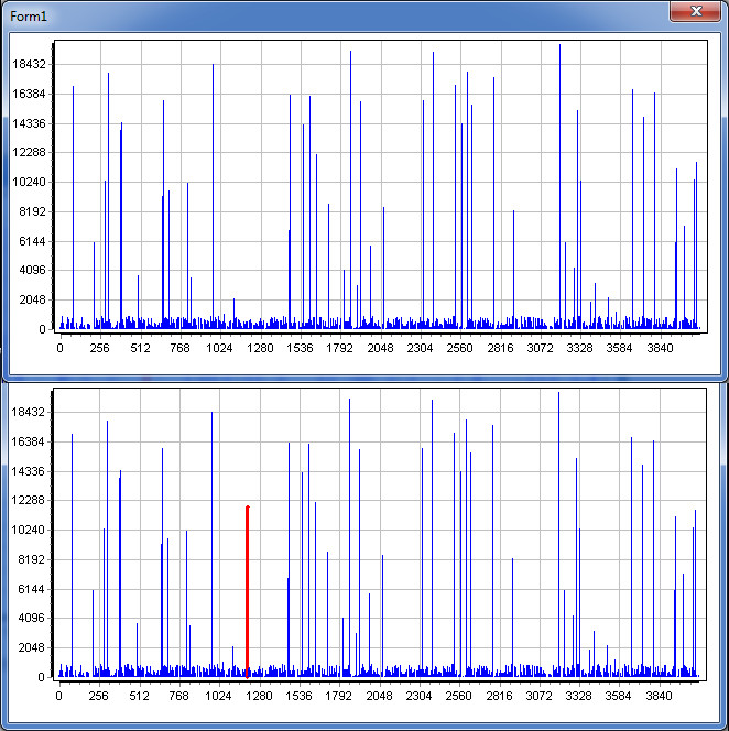

THistogramSeries does not Draw all its values see image and code. In fact - if you hover gently over the TChart - you will see alot of invisible values...

Try making the Pen Visible:
HistSeries.Pen.Visible:=true;

Thanks, that worked!
