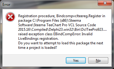

Re: Installing TeeChart PRO VCL Source issues
I attached image of error I am getting when I run DX10.
- dx10 problems
- teechart.png (39.08 KiB) Viewed 32637 times

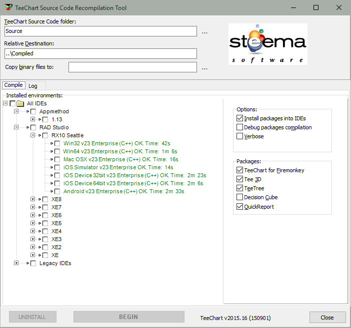

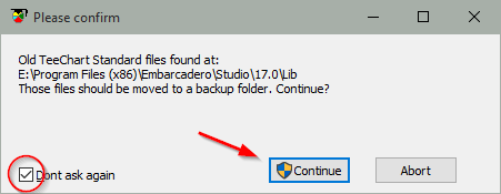

I've cleaned RAD 10 Seattle (unsistalled TeeChart Pro v2015.16 and reinsalled the TeeChart Standard/Lite components shipped with the IDE), I've downloaded and installed TeeChart Pro v2015.16 with sources.
I've ran TeeRecompile as admin, selected RAD 10 Seattle and left the rest of the default settings and it worked for me without problems:
I got a dialog where I was asked to accept creating the "Compiled" folder (I don't have that screenshot right now).
And I also got a dialog that asks me to accept to backup the TeeChart Standard/Lite that was shipped with the IDE: I can open the IDE without problems after that installation.
Could you please try the default options in TeeRecompile and attach a screenshot showing the options that make it crash for you?

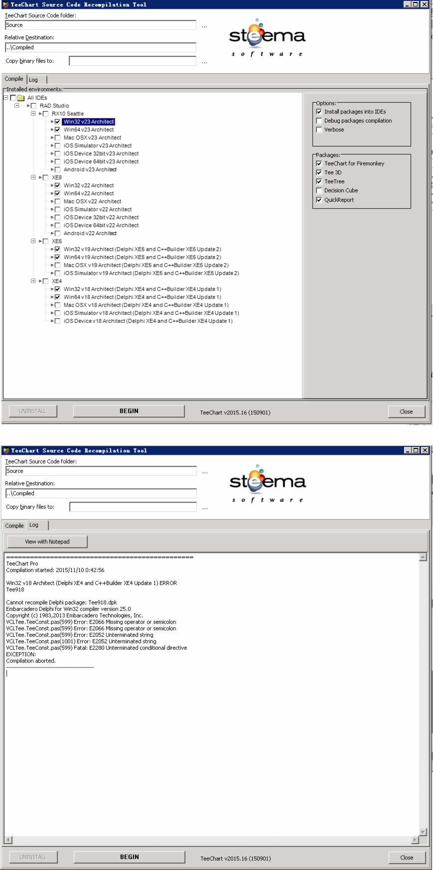

I have same problem in install TeeChart PRO VCL Source code,
OS: Windows server 2008, 64bit
IDE: Delphi XE8 ( I had try in XE4、XE5、XE8、XE10, ALL IDEs cannot install correct.)
Install file: TeeChartVCLSOURCE-2015.16.150901.exe
TeeConst may have been somehow corrupted in your machine at some point between the installation (TeeChartVCLSOURCE-2015.16.150901.exe) and running TeeRecompile.
To check that, you could install TeeChart with Sources again and make a backup of the "Sources" folder before doing anything else.
Then, you will always be able to take the original version of the files if anyone gets corrupted by any cause.
Note TeeRecompile takes the non-prefixed sources and creates the prefixed versions in the first stage; and puts them into VCL/FMX folders.
I see in your screenshot you are selecting several IDEs at the same time: RAD 10 Seattle, RAD XE8, etc. And it fails with that error when compiling for RAD XE8, so it has finished for RAD 10 Seattle. But I guess the file got corrupted between compiling for RAD 10 Seattle and for RAD XE8.
So I'd suggest you to do each compilation separately; and restore the original TeeConst file you backed up before each compilation; this is the file from the Sources folder, not the files with prefixes.
