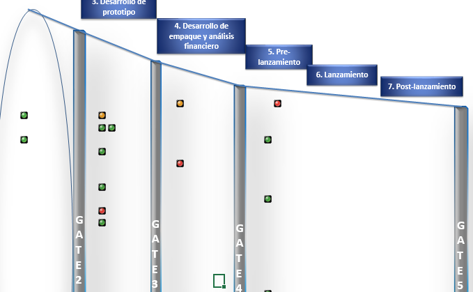

I have to combine volumepipe+bubble chart together. volumepipe = stages of projects, bubbles = project in current stage(radius = money costs).
*Is it possible? I was not successful in this task in design mode.bubbles were changing its position according many factors(radius, max y pos etc)
I tried to draw circles on canvas but i'm not able to determine area of one volumepipe segment.
How could I do that? something like this:
volumepipe
Thank you.
Lubos

- Calculate the polygons for the segments.
- Populate your TrProj structure with the desired data, still at OnCreate.
- At OnAfterDraw, loop for your TrProj structure as you do and manually draw your ellipses. Ie:
      Chart1.Canvas.Brush.Color:=pProj.color;
      Chart1.Canvas.Ellipse(Rect(pProj.x-pProj.r, pProj.y-pProj.r, pProj.x+pProj.r, pProj.y+pProj.r));
Note that this way you are storing absolute pixel positions to your pProj structure and, if you resize the chart the TVolumePipeSeries will be resized with it but not your ellipses. So if your chart is resized you should recalculate the polygons for the TVolumePipeSeries segments, repopulate your TrProj structure and repaint.
