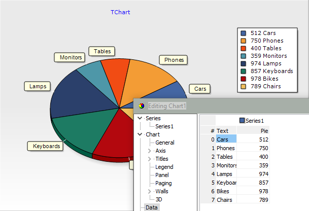

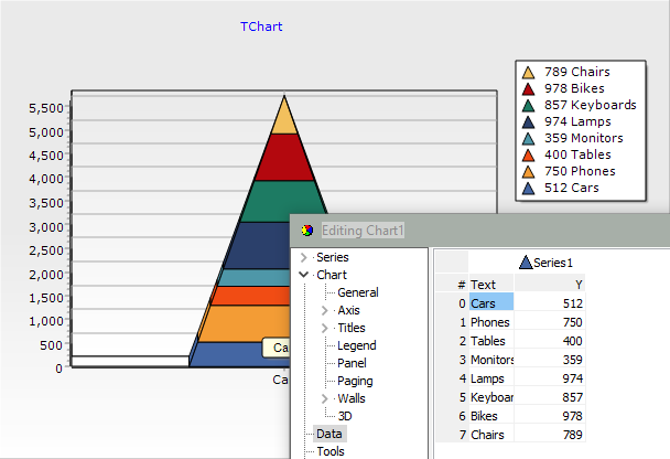

We are using Teechart Pro V2015 and Delphi XE6.When we change the chart style from pie to pyramid, the data order is inverted and labels don´t appear on each level of the pyramid. Could you explain us how to solve it?

This is what I see:
info wrote:When we change the chart style from pie to pyramid, the data order is inverted
I see the order of the points is inverted on the legend but kept at the Data editor.
Have you observed this was different in a previous version?
info wrote:labels don´t appear on each level of the pyramid. Could you explain us how to solve it?
I see only one mark is drawn correctly for the pyramid series.

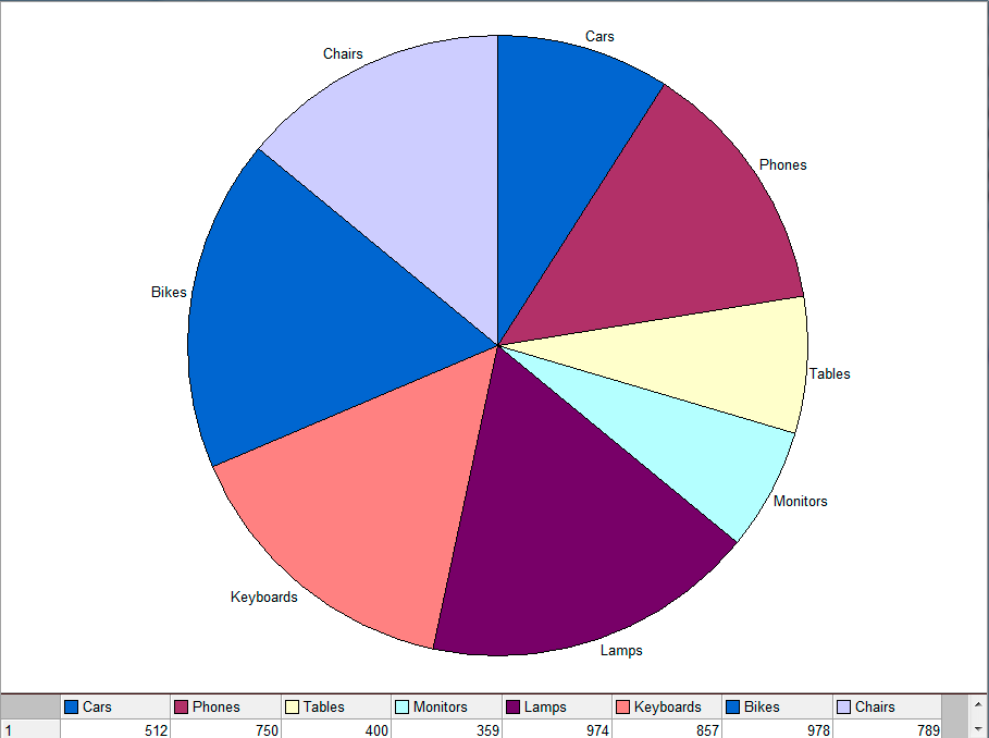

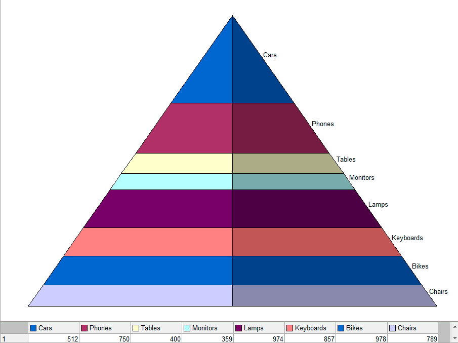

Hello, we are migrating from ChartFX to TeeChart.
ChartFX PIE
ChartFX Pyramid

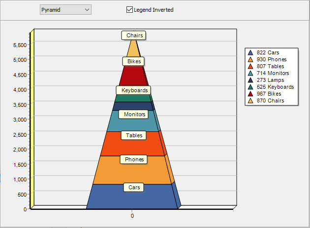

Regarding the legend, you can always manually invert it:
Chart1.Legend.Inverted:=true;
Here it is how it looks with the fix for id=1357 and the legend inverted:
Let me also attach the test project I used for future reference:
