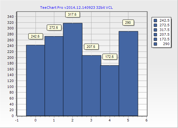

This is what I get with v2012.14 and the code below:
uses Series, TeeConst;
  Chart1.View3D:=false;
    FillSampleValues();
    BarWidthPercent:=100;

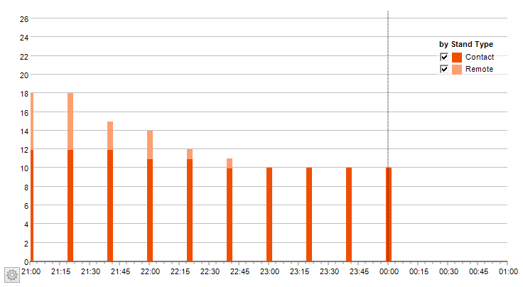

We experience a similar problem for TBarSeries where the bar widths are not aligned according to the preset BarWidthPercent when the x-axis is not set to automatic, i.e. does not show all existing values in the series. See the image below.
The settings are:
  • BarWidthPercent set to 70%
  • Bottom Axis with manual Minimum/Maximum, i.e. non-automatic mode. The intention is to display the values with respect to the current time (illustrated by the vertical ColorLineTool), i.e. it is a "moving window" where the axis bounds are frequently updated to focus the current time.

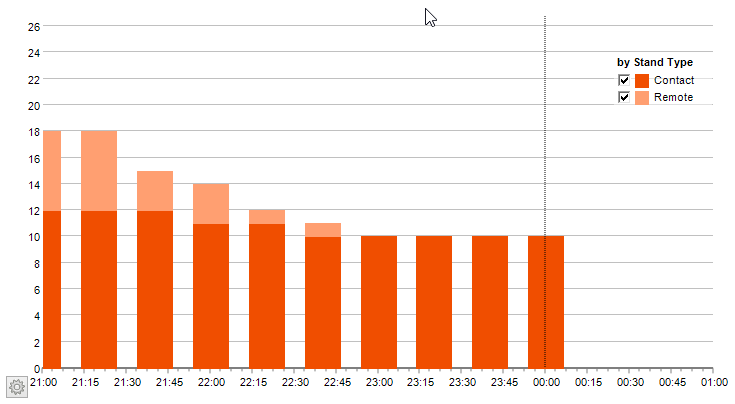

What we would expect is a result as shown below:
We achieved this by adding some code to TBarSeries.DoBeforeDrawChart (I omitted some local procedures to make it easier readable):
