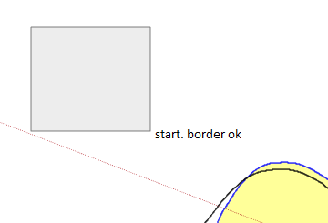

2) Colorbandtool border not displayed if created from left top to right bottom ? How can i fix this to have this border displayed correctly for all situation ?

Re: Bug and question suite
Post by Yeray » Mon May 30, 2016 9:10 am
I see the tool's Hover feature is interfering here. If you disable it (ie, at FormCreate) the border is drawn again:
  ChartTool2.Selected.Hover.Visible:=false;
