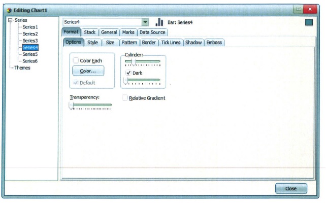

Thank you for that code. It works great, but I'm still having an issue. I'm not sure what's going on and am hoping you can point me in the right direction.
When I run your code in a brand new project (created in Delphi 10), it works exactly as you describe. However, when I add it to my existing project (originally created in Delphi 7), I get a "Themes" tab in the TChartEditor (please see attached screenshot). So I figured it had to be something with my project settings. I've gone through and made all the same changes to the new project (disabled runtime themes, added styles, etc). I've compared the .dpr line by line and also the form code for the TChart. They are exactly the same. Yet my old project has the Themes tab and the new one doesn't. Do you know what triggers that themes tab to appear in the editor? I can't send you my project because it's huge and proprietary, so I need to troubleshoot through discussion only. What I need is to either prevent the Themes node from appearing in the tree view to begin with, or a way to hide the tab (there is no cetThemes...).
Thanks!
SDE

Re: Open TChartEditor on a particular series
You may be loading TeeThemeEditor at some unit in your project. Note TeeThemeEditor is used in a few units: TeeChart, TeeChartPro, TeeDesignOptions and TeeEditPro. And some of these units are used in others, ie TeeChartActions and TeeComma units use TeeEditPro.
An option would be to call this in your project to clear any tab added by this method:
I think that's not an option because this tab is included by a method called in TeeThemeEditor initialization.sde wrote:(there is no cetThemes...).
Yeray, you're a genius! I removed the TeeComma unit that I wasn't even using anymore and voila, the themes tab went away. Thanks so much for troubleshooting with me!
